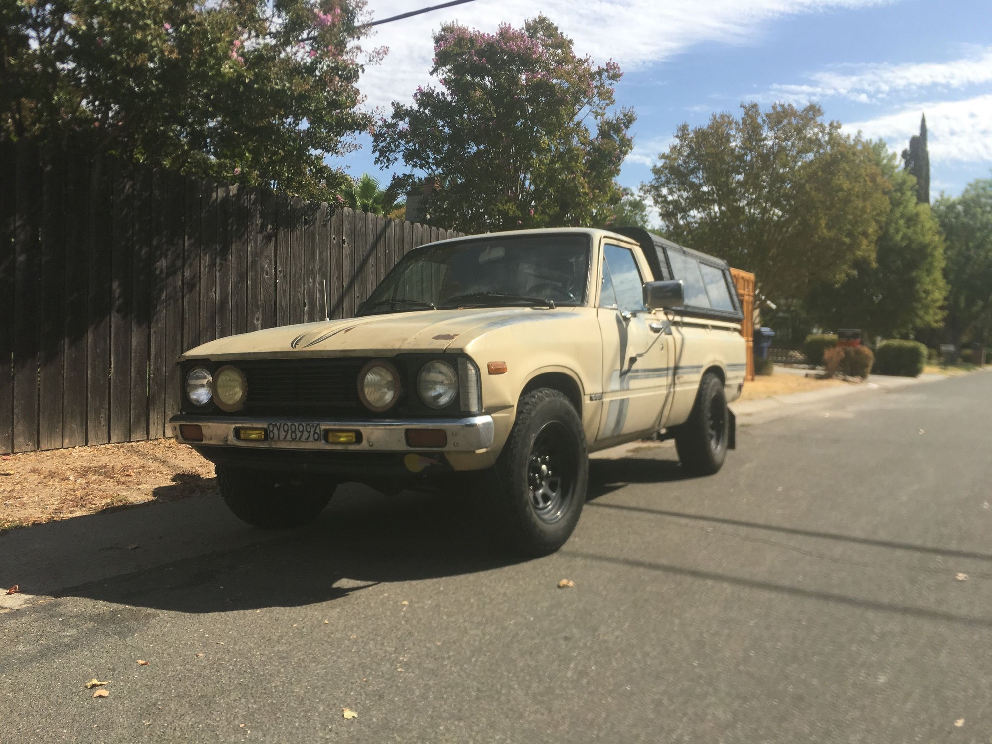

1980 pickup new alternator starterand battery - was moving right along last night when I lost power to everything but the headlights. No crank or attempt to turn over. The only sign of battery life is the headlights
Looking around today nothing is apparently disconnected.
Interested in learning how to diagnose and solve these issues- not highly interested in putting it in the shop.
Sir’s and ladies... any insight or inquiry would be much appreciated.
