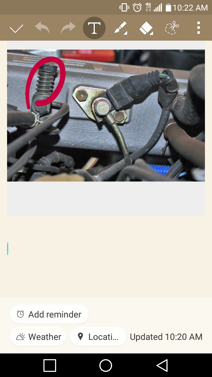

Does anyone know what this part is called
I have a 22r 91 Toyota Pickup. I suddenly saw this missing, but I dont know the specific name for this part. I appreciate everyones help!
Attached Thumbnails Does anyone know what this part is called-screenshot_2015-10-30-10-22-10.png

I don't know the correct name for it but I think if your truck does not have AC, you will not have it if I am correct on that.

My truck has AC and it still works with out that spring thing. I have seen it before in my engine but i never thought that it would fall out of place. Now im trying to replace but I can not figure out the name of it, thanks for the help though! By the way, i have moved that spring before and it would change my idle to high or low, depending on how you would rotate it.

Now I am not sure just what year the were no longer used.
You would have a fitting on the pump if you need one
Screwed into the pump with two nipples
But it is the valve for the power steering pump
One line goes over to the power steering pump the other one comes off the manifold I did not look just where.
If it came off it would be hanging there some place .

A/C idle up valve. Is used to bump the engine idle when the a/c is on if idle is too low.

Thank you guys alot! So it is called the A/C Idle Set Screw, now to find that part and replace it asap because its idling up and down like crazy haha
