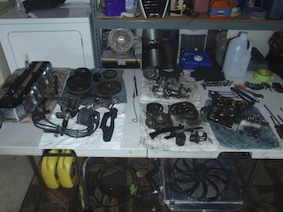

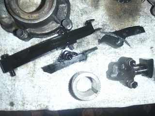

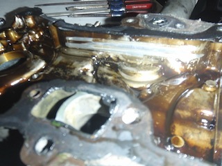

so i tryed to get the video but u cant here anything so i took the valve cover to take a peek and you guys were right busted chain guide so i ordered parts and began taking it apart b4 it got any worse i snapped some pics the chain also ate up my timing chain cover a bit too

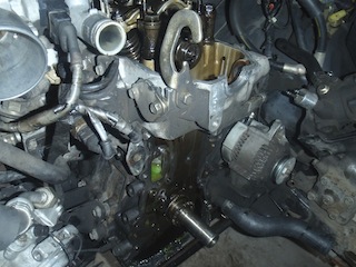

everything came apart pretty easy ive never taken the timing cover off before w/o removing the head but it worked out nicely thanks for the tip xxxtream22r

if the guide has already broken, your gonna have to drop that oil pan to clean it out as there will be shards of plastic if not pieces of the timing cover in there. You don;t want that stuff floating around.
