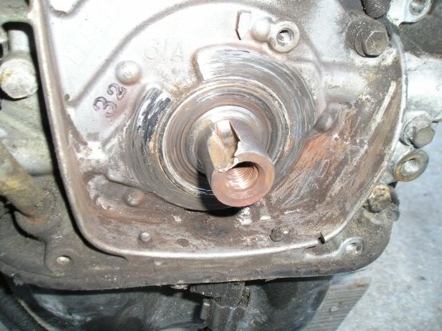

Originally Posted by millball
Damper is toast. Better that than buggered up crank snout.
I want to see a buggered up crank snout

Well, since this is a family show, this is all you get:
Old Dec 26, 2016 | 12:38 PM
