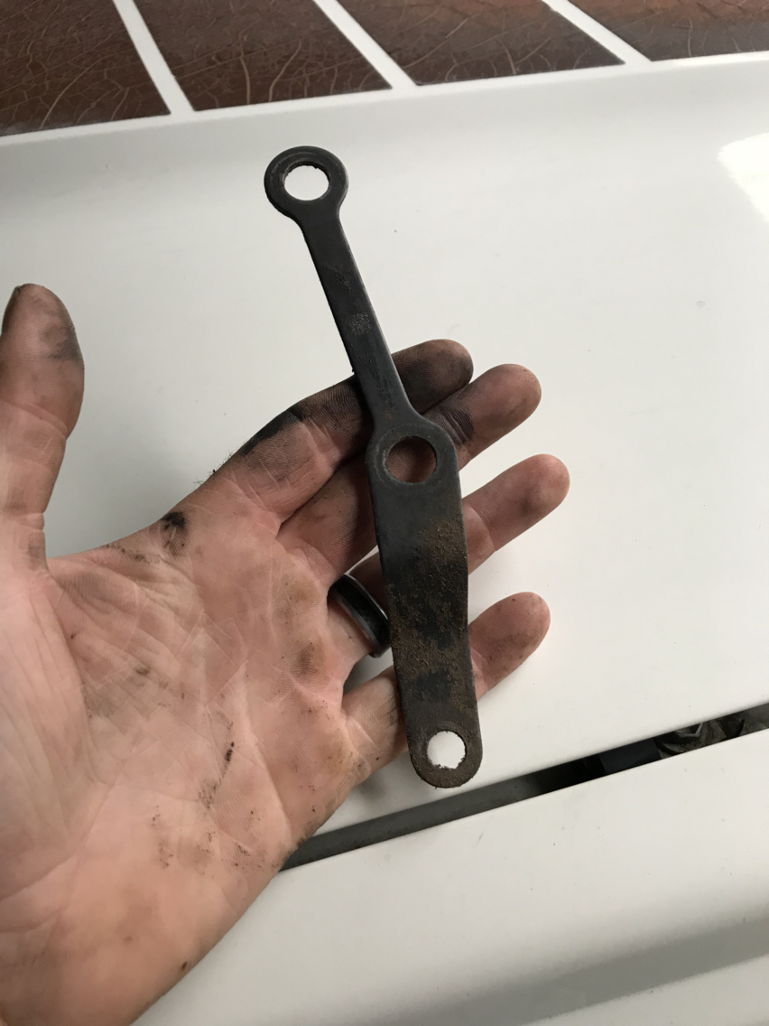

Ok so I cant find a tap and dye locally or any bolts or nuts to try and clean up the threads. The OEM bolts look like the got the worse end of it. With some patience and a bit of oil I was able to get the to both thread back in by hand, the bolt threads are a bit better. I believe they will hold fine until I upgrade my brakes.
So now my next 2 questions.
A: I am looking at extending the brake lines when I put the lift on. Do these typically go direct to the caliper hard line or do they bypass the stupid hard line and go direct to the caliper?
B: There is a bracket that has a 12mm bolt that goes in to the brake line bracket where the hard and soft line join, and then to the 2 brake caliper bolts. Is this bracket necessary? If so for shimming the caliper bolts then can i cut the brake line bolt tab off.
With the hard lines it's challenging to get the beat up bolts to thread in with the tension on the hard line working against the bracket.
Edit: looking at extended brake line options i see some guys running 2 stock rear lines for the front "extended option. I don't like the extra joint in the line but that gives them a male female hook up to go in to the caliper from what i have read. Then looking at marlins website i see they sell the 26" "extended brake line kit for the front female/female. And a 26" male/female for the real. Any reason this rear extended line from Marlin wouldn't work for the front?
