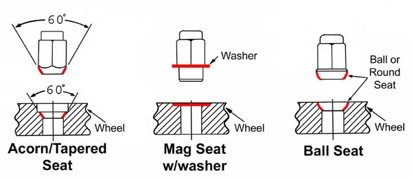

The studs are the same between steely's and alloys. Te difference is in the lug nuts themselves.
Here's a pretty good explanation. The steel wheels use the lug nuts on the far right, and the stock Toyota alloys use the center lug nuts.
I see now, but I can't remember exactly what my lug nuts looked like. I want to say they were tapered. So now if purchase the wheels I want, I would need to purchase the correct lug nuts right? Then when it comes to balancing the wheels would go with lug centric balancing or hub centric balancing?

Exactly. Most tire shops can get you a new set of lug nuts.
