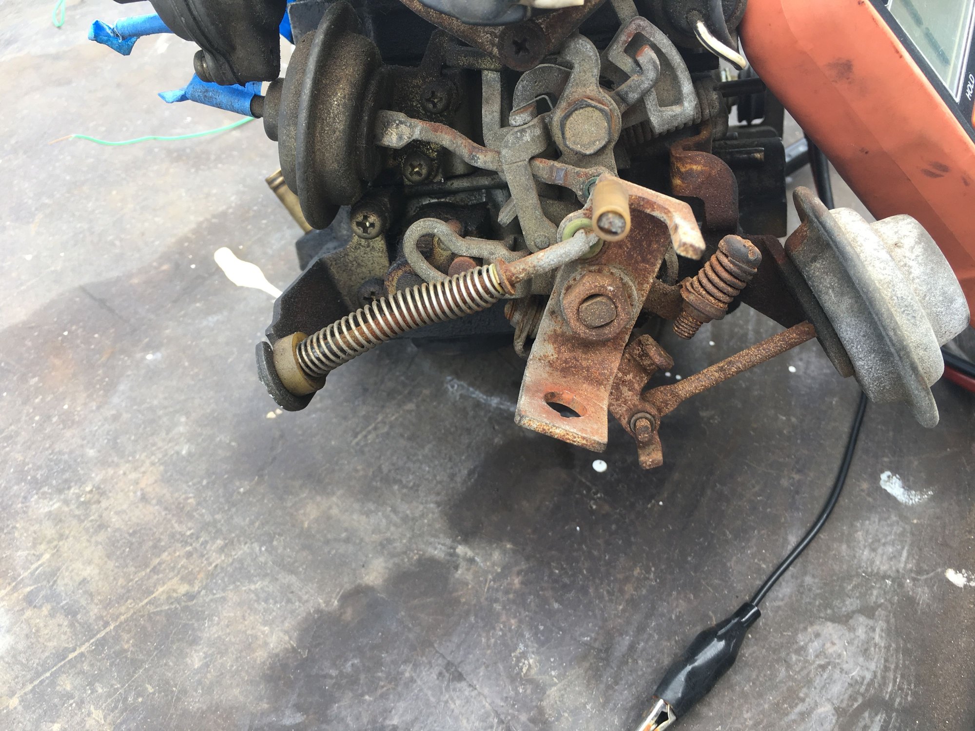

Rebuilding a stock carb on a 87 Toyota pickup, I have a couple questions, only one of the four bolts had a lock washer, should they all have lock washers? Also the armature is rusty, should I apply grease,oil or paint it?

Can I assume you're talking about the (4) bolts in the air horn? I think one of them has the carb tag but they all should have a small lock washer. What "armature" are you talking about? The air horn, main body, and throttle body can all go into your can of carb cleaner to soak. Anything else, like your choke opener, has a diaphragm inside and cannot be soaked. You'll need to sand, scrub with vinegar, or CLR to get the rust off.

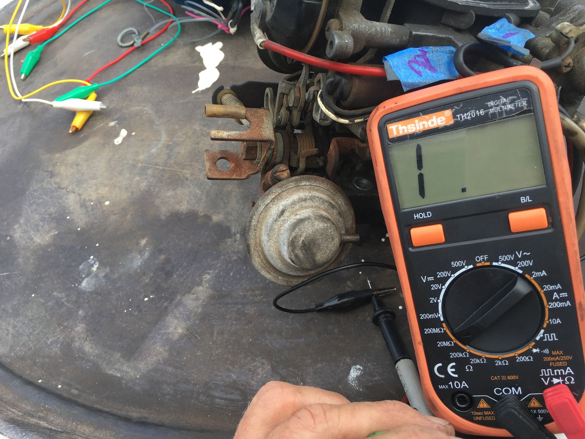

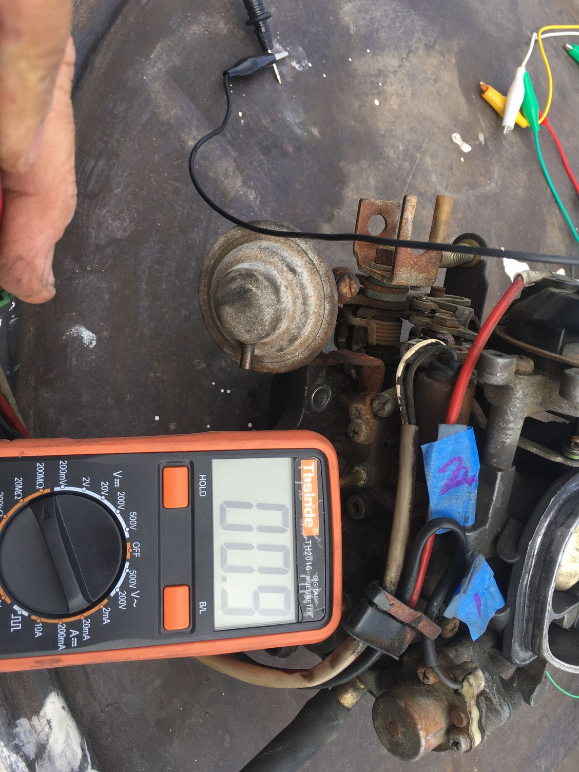

Choke reading
Ovcv reading
Armature

So I am having trouble getting a reading on the two components shown, I tried all the ohm settings, I decided to just oil the armature thingys

Take pictures of the throttle/choke linkage before you start. Once you take it apart you can get a 12v battery and test the solenoid fuel cut-off, the outer control vent, and the choke heater then. All the rust on the throttle linkage will get soaked in your carb can and you can scrub it later. Remove the Idle-up and the choke breaker diaphragms along with the choke assembly.
One thing you want to avoid is soaking any aluminium parts in vinegar or CLR or allowing it to soak. If left too long it will completely melt/dissolve aluminium. So use the vinegar or CLR on steel parts only. Another tip, a wire brush in your drill motor will be your new best friend for rust removal. Use it to clean and polish your parts and screws. Definitely don't paint the linkage and it won't stick to the cast aluminium body. I just used a wire wheel and cleaned as much rust and grime off as possible. Patina is the new in thing anyways.

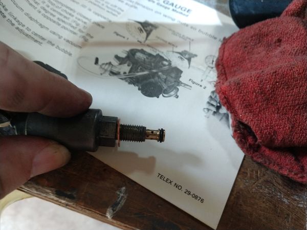

I believe I told you wrong concerning the FC solenoid O-rings. After pulling another FC solenoid from a spare carb I have it had the O-ring installed on the tip of the solenoid, which is the way I originally thought it should be installed. I say this because the diagram is not clear at all. There should be a small skinny O-ring on the tip and the only washer installed past the threads is the brass washer. With a little silicone spray the FC solenoid should slide right in without pushing the O-ring off the tip. If it doesn't go in then you probably have the wrong O-ring installed.

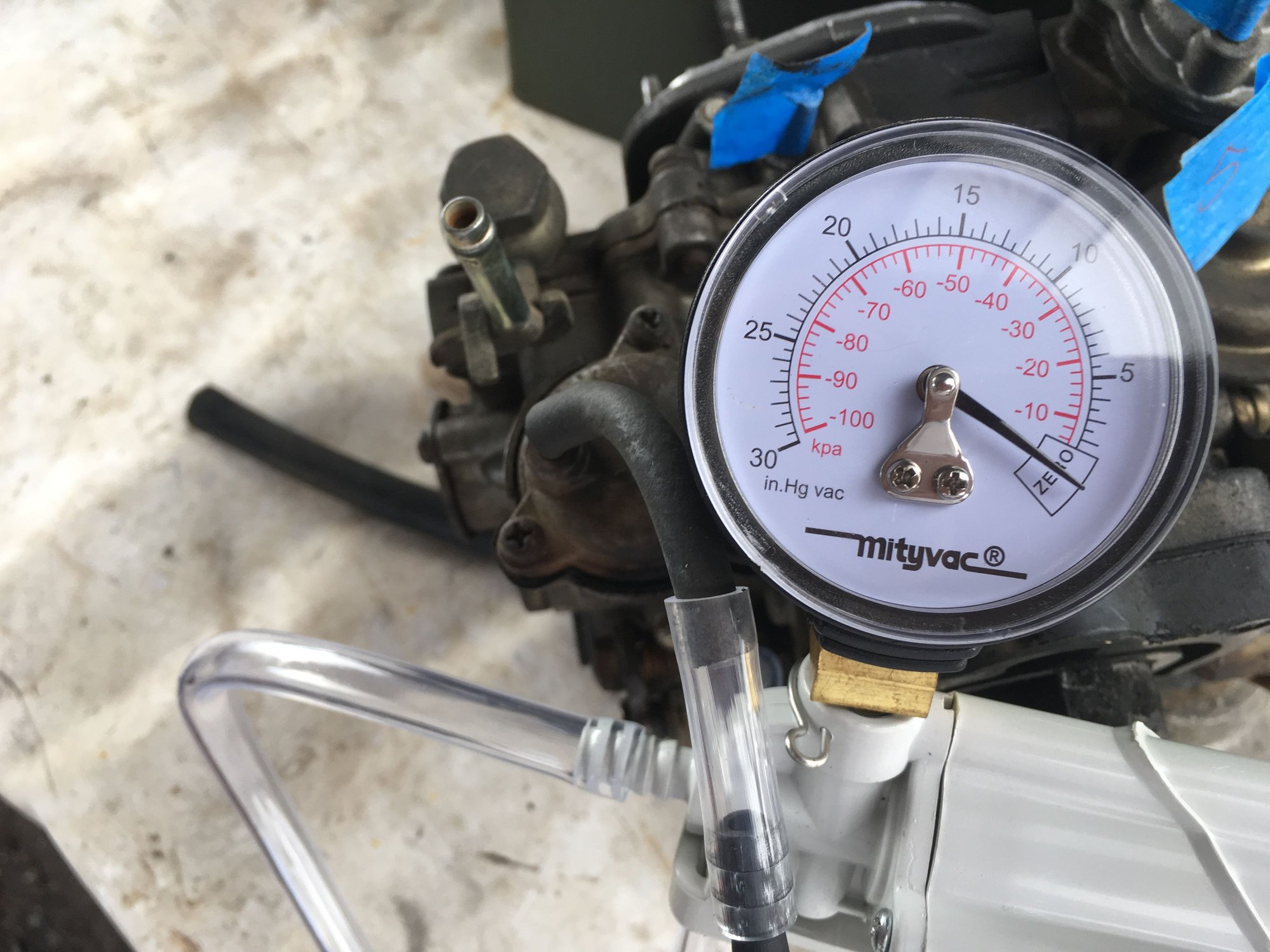

Thanks Tim, I was wanting to check the vacum diapragms(?) looks to be three of them, not having luck finding the specs on that
anyone have those?

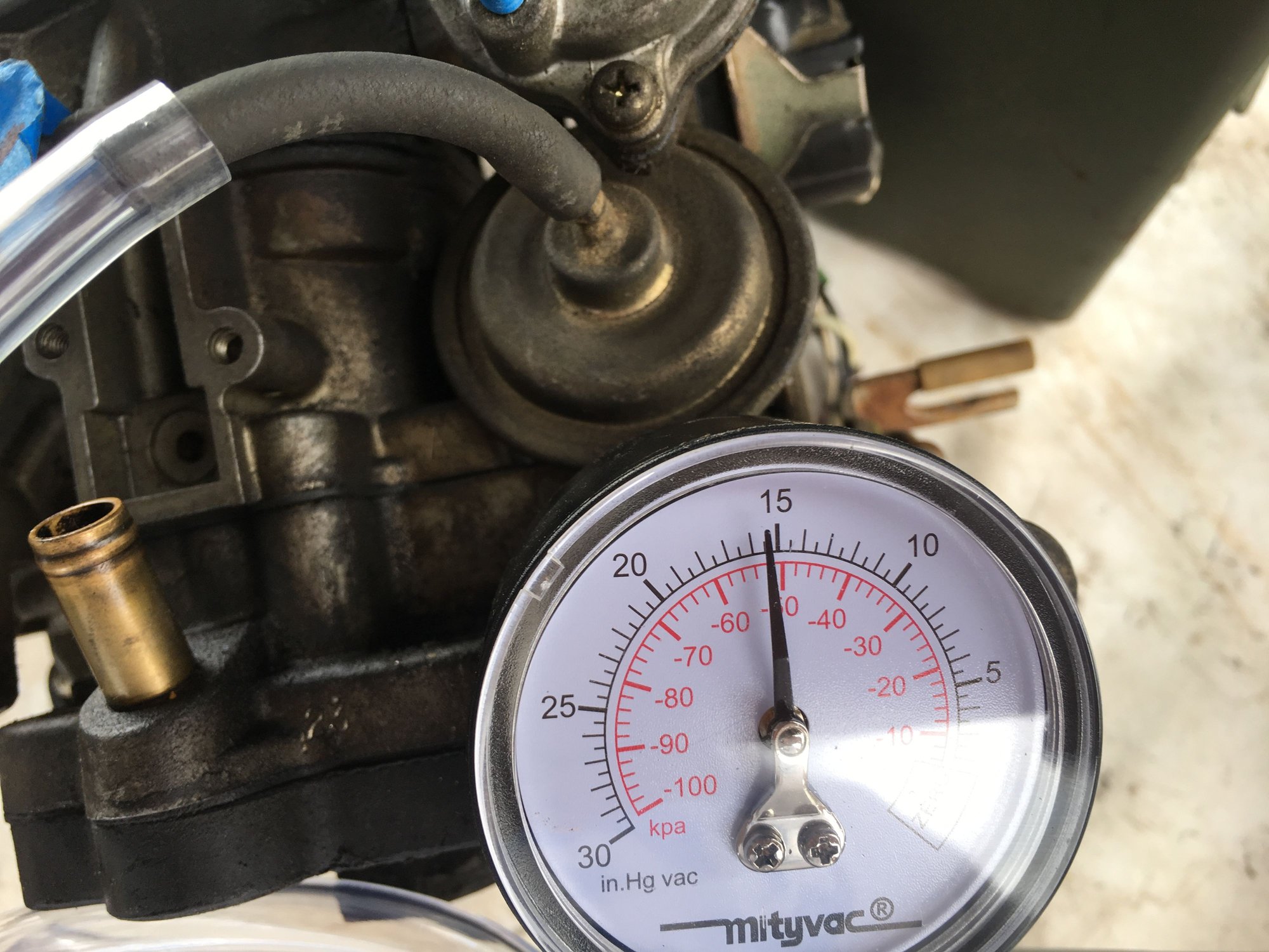

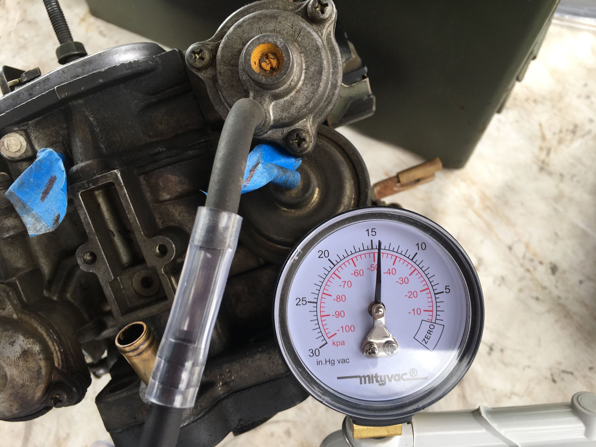

No specs needed. Just use a vacuum bleeder. Pump them up to about 15 inHg and make sure they actuate the linkage and hold pressure. A very slow bleed off is Ok as it's usually your vacuum bleeder hose/fitting and not the diaphragm. If it bleeds off as fast as you can pump it then it's toast.

Thanks Tim, I will check it out and take some pics

Looks good
Good
Not good
Good

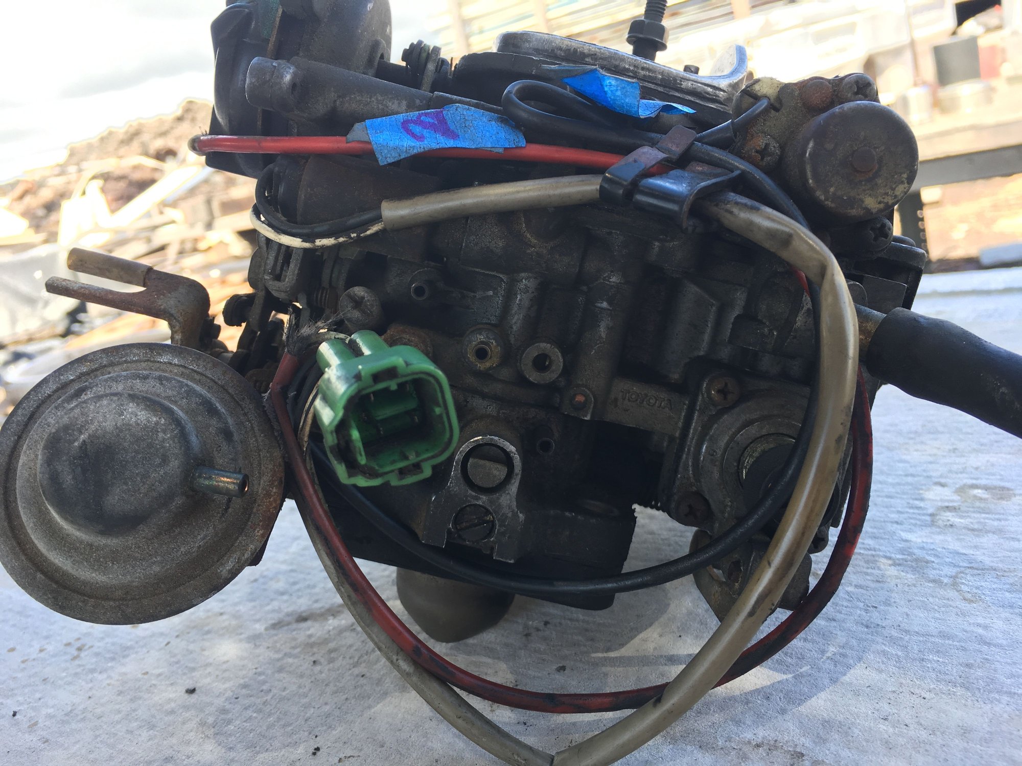

Could not remove this, seems like these are two screws with no head or rivets?
This started to strip, I will replace it
I am going slow with the linkage and taking lots of pics, does anyone know of any availabile diagrams, hopefully I dont need it

The "bad" vacuum diaphragm is your Auxiliary Accelerator Pump. Not surprising. You'll get a new one with your kit along with a diagram. I'd soak all your screws in some penetrating oil before trying to tear it down. Especially the screw in the middle of your air horn next to the air cleaner stud.
The Outer vent control is just stuck. Once the 3 screws are removed there should be nothing else holding it on. Try using a gasket scraper and drive it between the body and the spacer. It should pop off.
