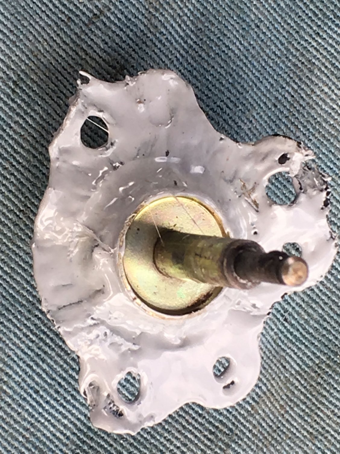

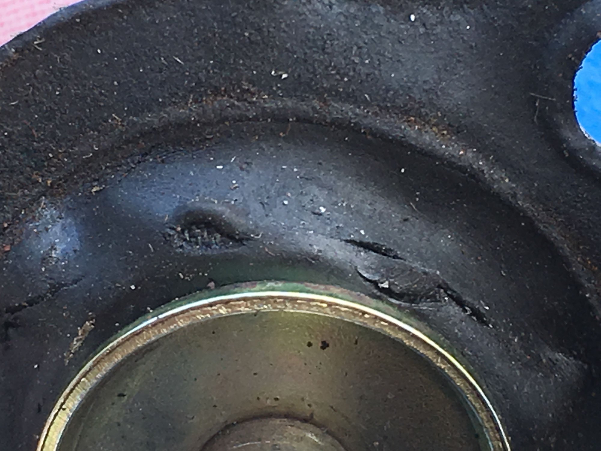

Here is the old ovcv diaphragm, could not find a new one
The diaphragm is damaged, I could see the pin hole when I held it up to the light

I coated the ovcv diaphragm with silicon , I could not find a replacement part, I guess Toyota wants people to just buy a new carburetor

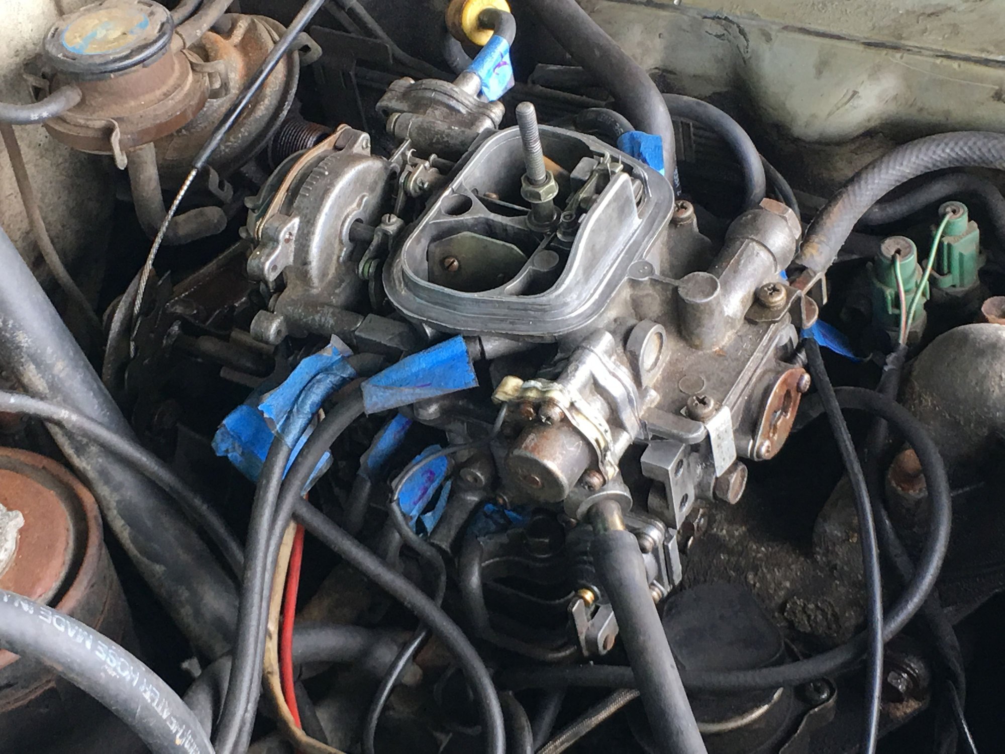

Got it all put back together, runs good, I am happy with it, Thanks for all your help Tim
