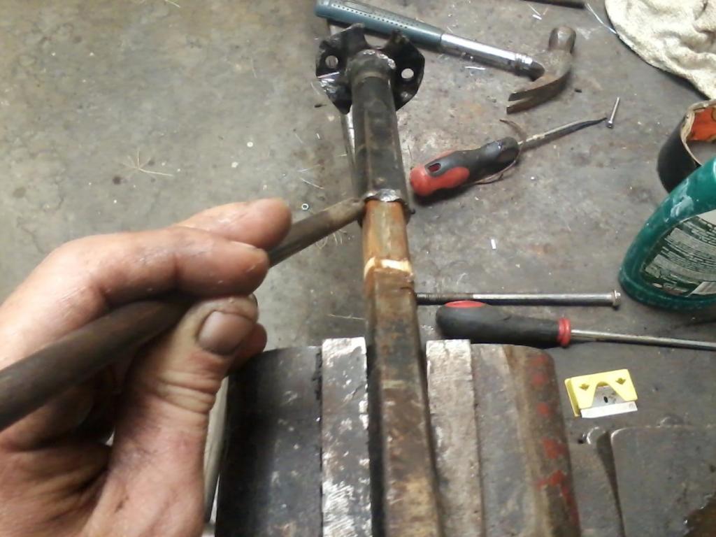

I have not seen an extention like the one you posted. About an inch will stick into the column and into the rag joint connector, it will bottom out.
In the center of the shaft, it should expand and contract. Most are rusted and wont budge. It is designed to collapse in the event of a head on collision.
Here is how I went about and did mine.
Copied...
Should be able to remove bolt and then compress shaft to get out. Most shaft will not compress due to rusted together. With the shaft in a vise and a hammer, I got it to seperate.

I had to use a punch on this to get to seperate along with trying to compress it with a rubber hammer. Finally got it. I cleaned it up and it is operating great now. I do have a spare that I might use instead.
