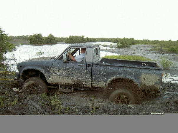

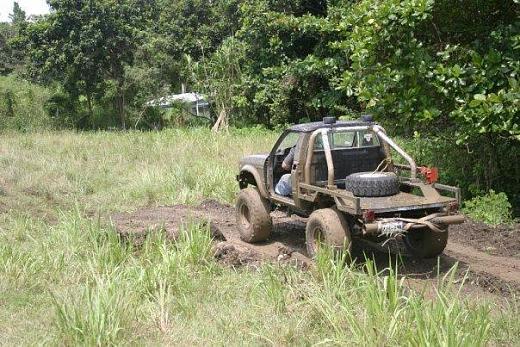

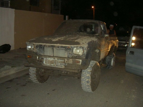

Hi everyone!
I'm from Puerto Rico. I have a 1983 Toyota pickup. I bougth it 3 years ago and I been mudding around here since then. My question is what you guys think ins the best ratio my diffs should have for mudding? I have an almost stock engine (as far as I know) whit 33 x 12.5 15's. I believe the truck came whit 4.10's from the factory but since I'm ruining big tires I believe I should go with a higher ratio. There is a lot of mud in here not much rocks.
Here are some pictures of how I bought it and how it looks now. I made a flat bed and a winch bumper for it.
