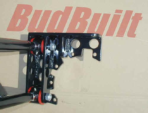

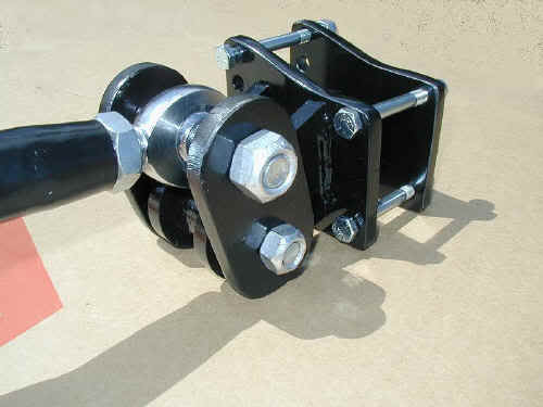

if you don't wanna get to springs to eliminate axle wrap-get a ladder bar:
https://www.budbuilt.com/new/traction_bars.html

Old Jun 18, 2011 | 06:41 PM
MudHippy's Avatar
Joined: Jan 2007
Posts: 6,106
Likes: 27
On the minimum required equipment list IMO. But, it doesn't solve every issue with them. For that you'd probably want a panhard bar too. Won't find that on your 88 yota from the factory either.
Why do I think that?
In my personal experience with 2" blocks in the rear, which was NOT good, they also have another inherent weakness that can cause catastrophic damage. What ended up being problem with mine was not the axle wrap alone, which was tolerable(to a point, as you'll see). It was only when they both cracked into pieces and fell out that it was extreme enough of a problem to be called intolerable. That intolerance could be measured in the number of twists in my rear driveshaft caused by MASSIVE axle wrap(like try having no nuts on your u-bolts type, as loose as they were then). The way they appeared to have been destroyed was by a horizontal twisting/pushing/pulling action(basically forced in every other direction too, besides wrapping around the axle housing). They weren't smashed or cracked length wise. They both cracked in half near the middle of their width. An anology would be if you could grab a brick at each end and break it over your knee, or twist it in half. Axle wrap wouldn't cause that kind of a break. Wheeling so hard that your rear axle wants to tear itself off the ass-end of your truck sideways will though. For that I don't recommend lift blocks...
