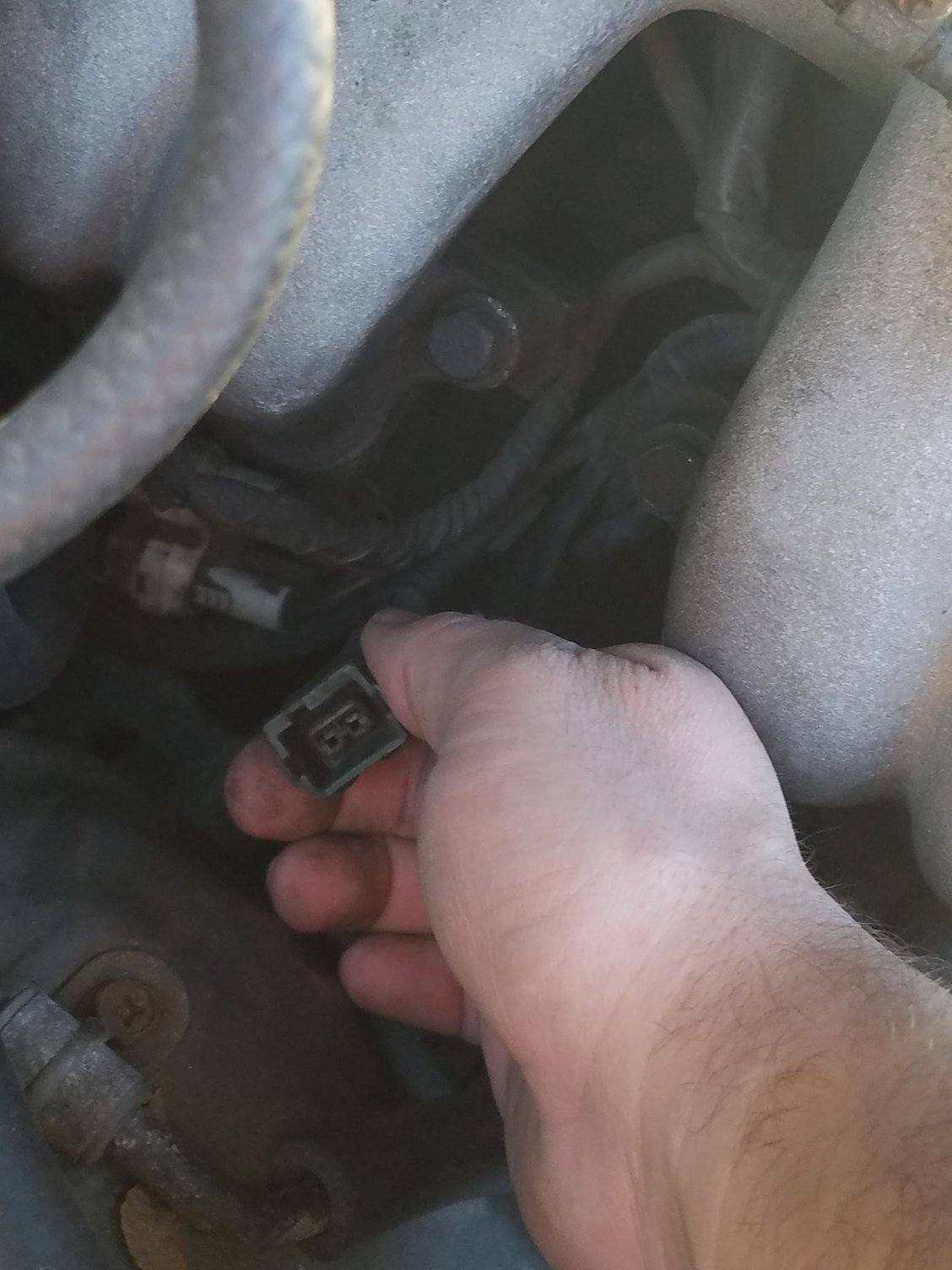

Question Any ideas to what this plug is for?
Plug matches a plug that i have for where vacuum lines connect to but no where that i see where it connects to on that one.

What make model and year? Looks like the intake side of a 22re in the picture, but for clarity sake it would be good info. If this is a pre 1989 4Runner with 22re, then that might be the plug for the IACV or sometimes called the AAV that is right there under the intake.

It is a 87 4runner 22r 4wd
