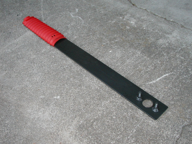

On my t100 There are two small holes in the pulley that a tool fits in to. Its a long bar with a hole in the center so you can get the wrench in there but the tabs hold the pulley still so you can break the bolt. we ended up making one. cranking the engine for a second will work also. But I havnt tried that.
Ill try to find a picture

Old Jul 21, 2013 | 12:49 PM
Zpd426's Avatar
Joined: Mar 2011
Posts: 505
From: Socal
This is almost exactly what I made but I found this one searching for "toyota crank pulley holder tool"

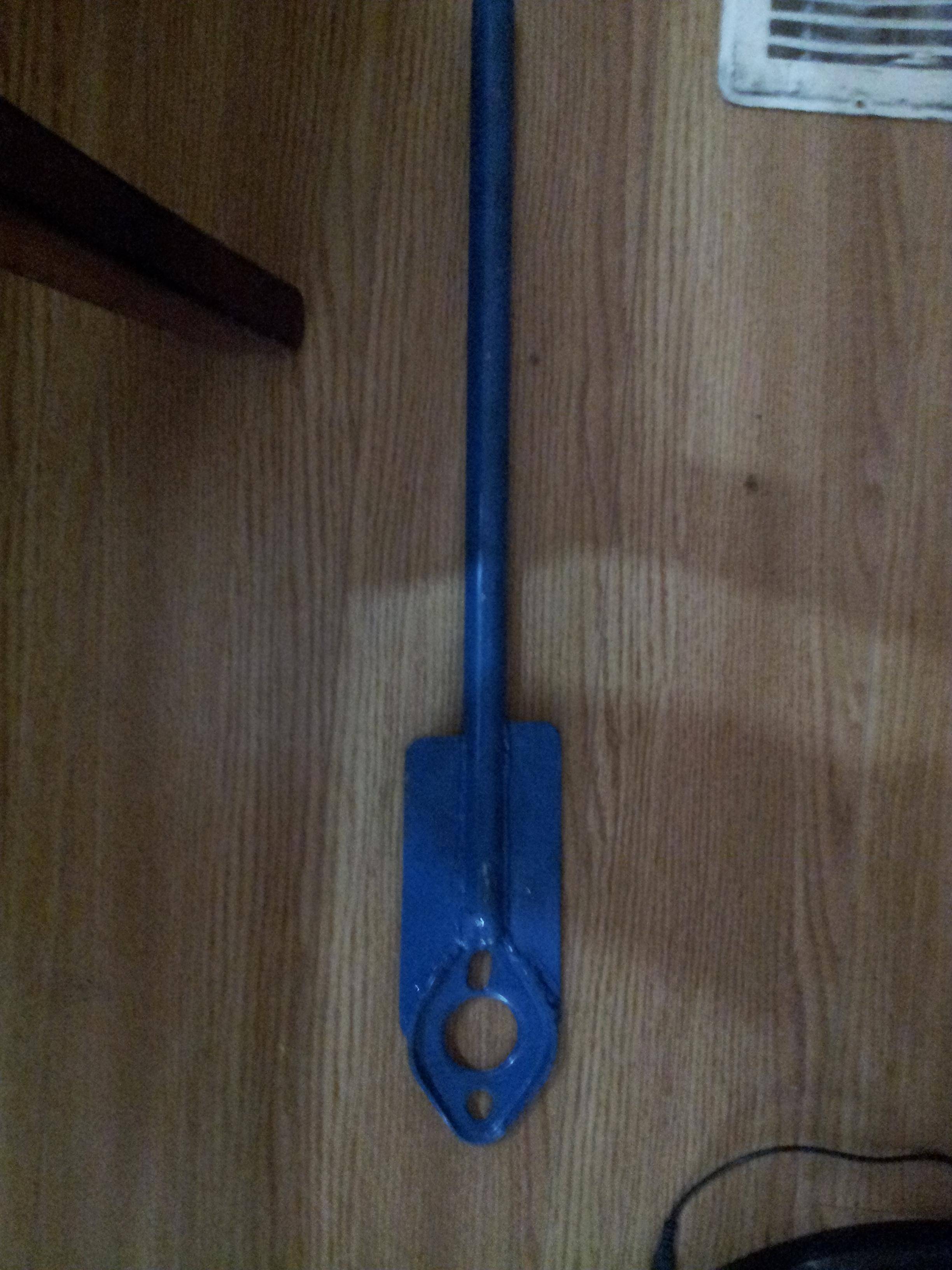

Bullet22r's Avatar
Joined: Oct 2012
Posts: 125
this is the one i built for my 04 sienna does the job right and fits up to a 24mm impact socket well.
