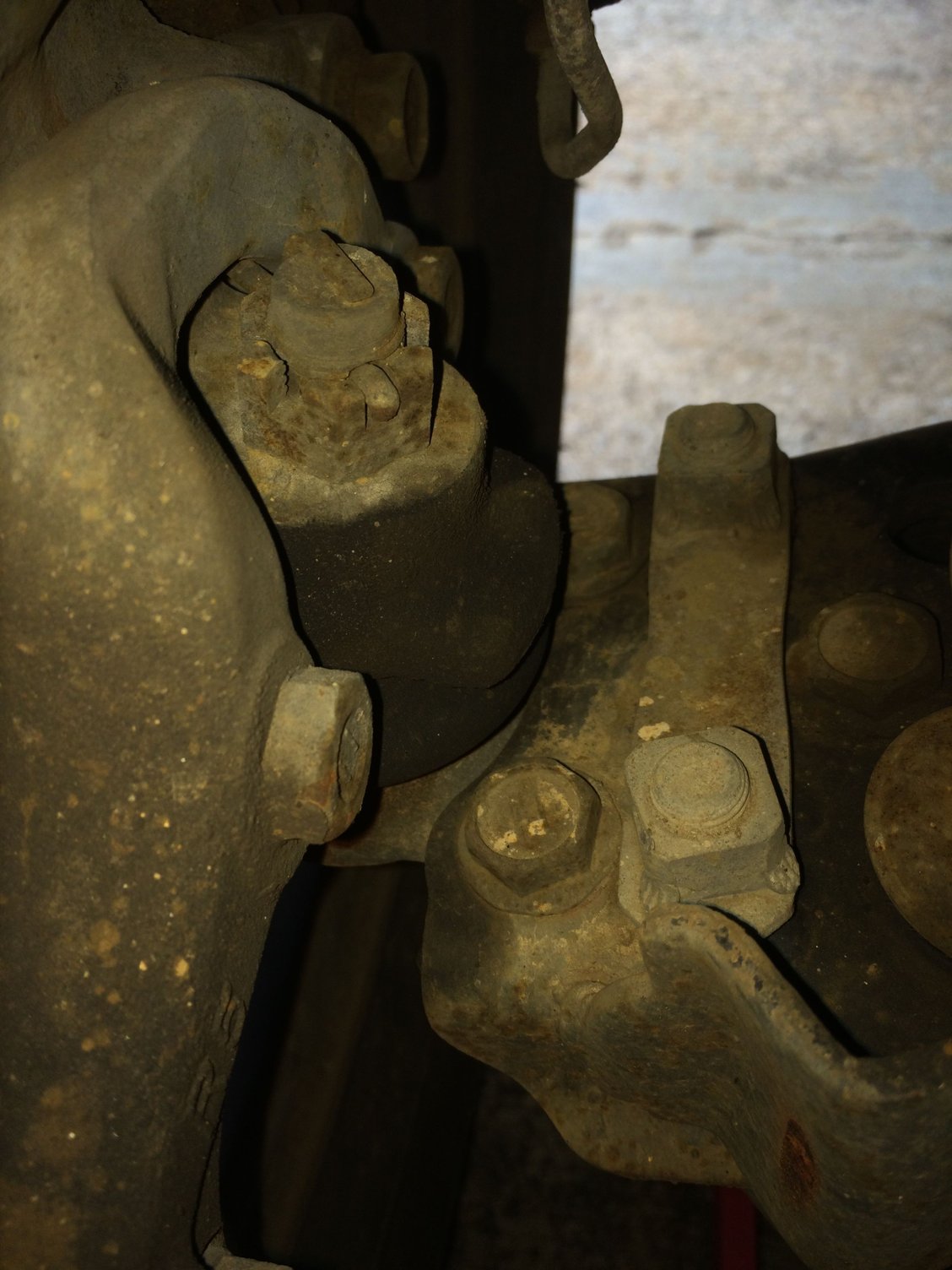

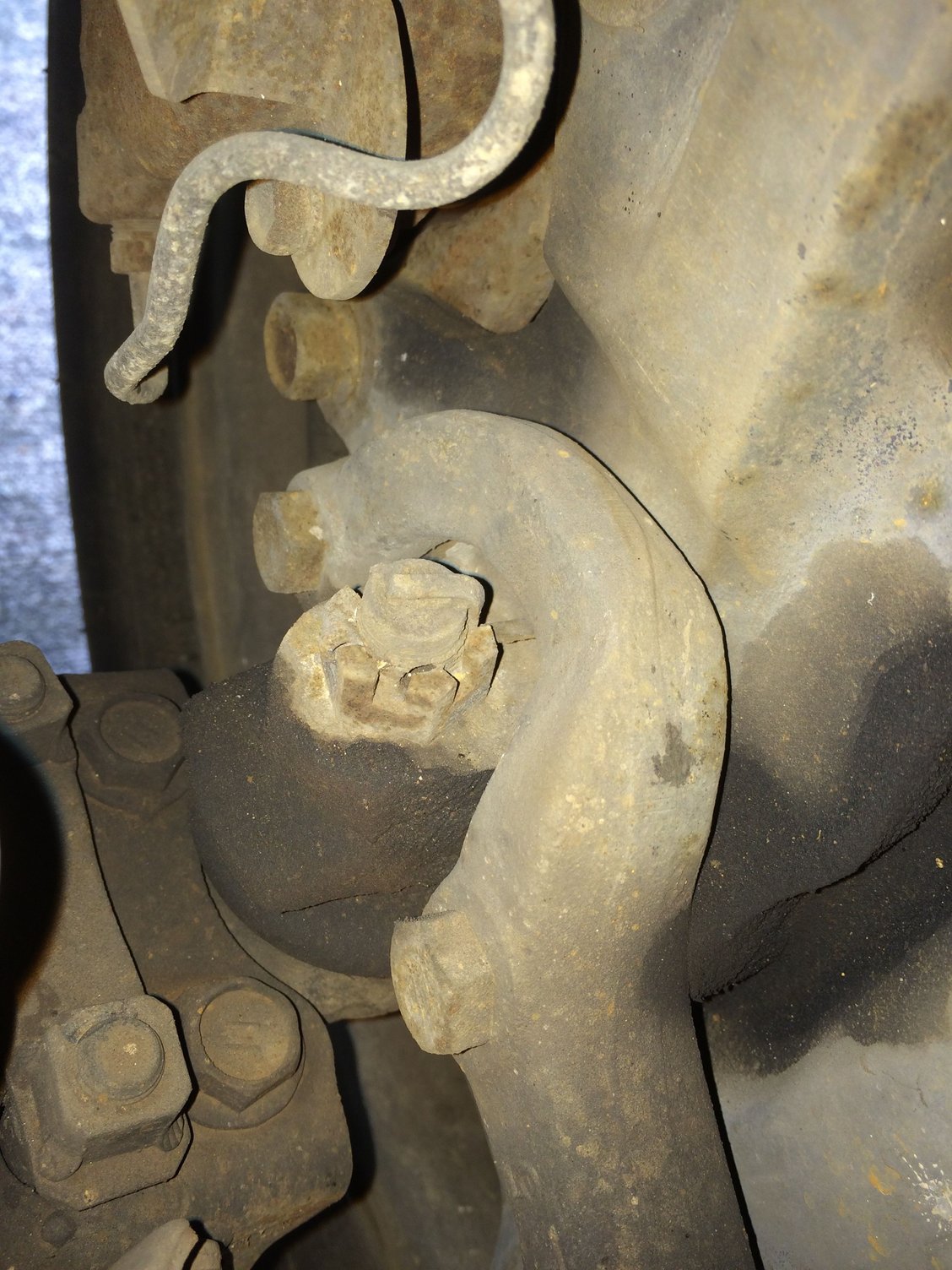

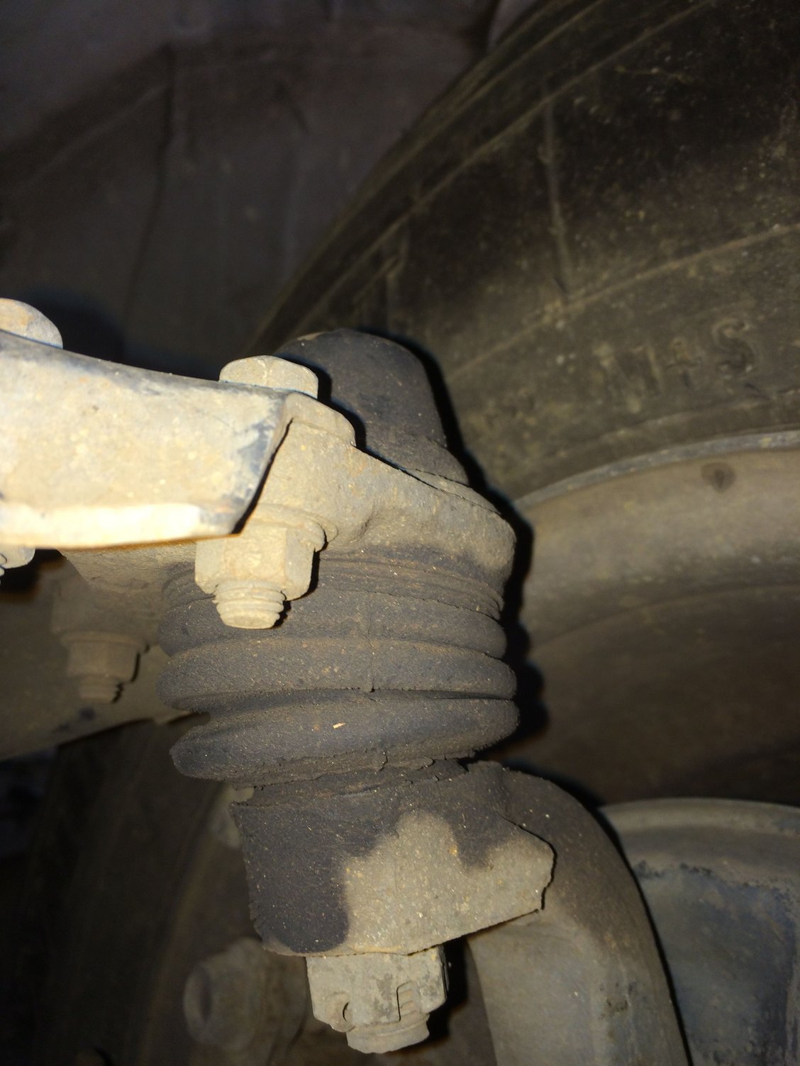

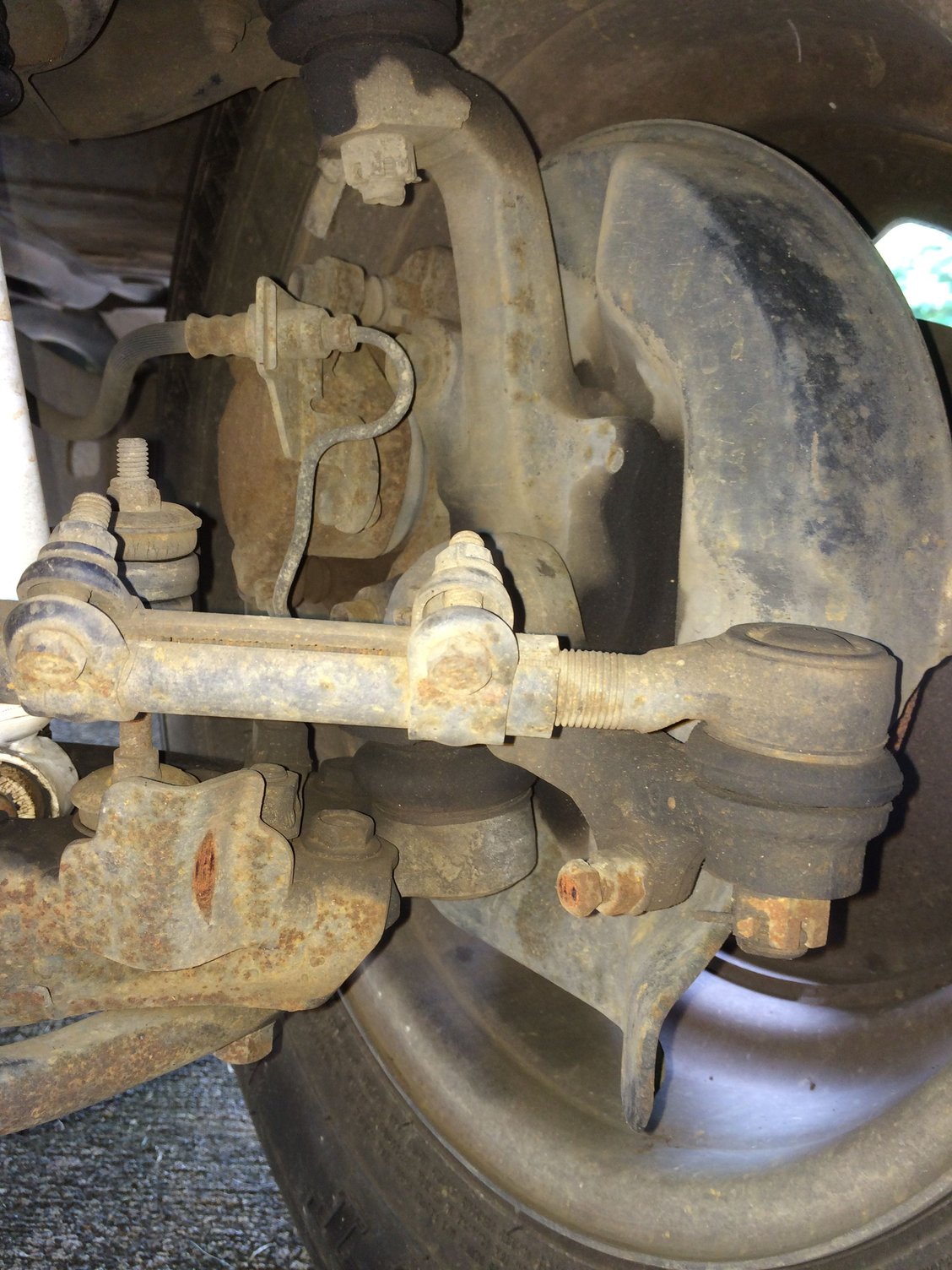

Ok, so I followed the troubleshooting advice and put each side up on the jack and applied torque to each wheel vertically and horizontally. There was zero play vertically and slight play horizontally. Does this imply my tie rods/bushings are shot? I didn't have a friend around to help with the steering test but can do that later today. I am posting pics I took today of all the ball joints, tie rod ends and steering dampener. I need some help in prioritizing which repair to do first:
1. Tires (includes balancing etc..)
2. Tie Rod Ends
3. Ball Joints (upper and lower)
4. Alignment (all 3 will require this but I cannot afford to do it all right now)
The creaking noise is only when I go over a bump and have the wheel cranked all the way right or left. The steering wheel/front end wobble only occurs at 43-47mph range and is attenuated at all other speeds.

The creaking noise is probably the steering stops. Its a common thing on these trucks. The steering stops are located on the steering arm by the outer tierod end and rub the plate on the lower arm. You can see where it rubs in this picture you posted. Try putting a little grease on the plate and see if the noise changes or goes away. I would also look at all the bushings in the arms too. I can see the sway bar end link bushings are cracked and need to be replaced.
The list you made seems to be ok to me. You just don't want to wait too long between new tires and the alignment.

Sometimes the head of the steering stop bolt in the picture rubs the dry contact area and squeaks. Try adding some thick Moly grease to them and see if the noise goes away.
If it eliminates the noise just grease it again when makes noise or you can get caps for them for about $35-45. off of ebay. I think they fit just about all the 85-95 4wd trucks and 4Runners.
They may or may not fit some 2wd trucks. I think this is because of the size of the bolt head. I guess a person could always change the bolt out if they really wanted to use them. They'll probably decrease your turning radius a little because there is no cap on there at the moment.

Spot on...I had the same issue with my 94 Pathy and put axle grease on the steering stops to quiet the creaking noise. Thank you both for reminding me,funny how you forget stuff overtime. I will pick up some grease tomorrow and report back. I will look into the sway bar bushings. I think the best course of action right now is to replace the tires (balanced), then have an alignment done immediately. If possible I will replace the sway bar bushings prior to the alignment. I think I will revamp the entire front end steering/suspension in january time/money permitting. I think I can make it until then with what I have going.
