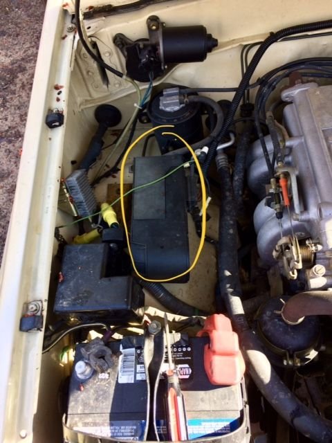

Unfortunately yesterday she got struck by lightning and it absolutely shredded the front passenger side tire. Now there is a fan constantly running while the ignition is off and all lights are off in this black box in the upper left corner (passenger side) of the engine compartment.
I'm not sure what it is... but I pulled the negative terminal off and the fan obviously shuts off but when connected it immediately turns back on.
The image below shows the box. Can someone help me identify this?!?
Thanks for all the help and expertise... really appreciate your time and thoughts.

That is some sort of aftermarket gizmo. I am not sure what it is. Are there any markings on it?

Hi, thanks for the response... no there really are not but one line goes to the throttle and another to the dash, one other somewheres down toward the motor.
There is cruise control on it... that's the only aftermarket addition I think it's got.
I'll keep doing some research!
