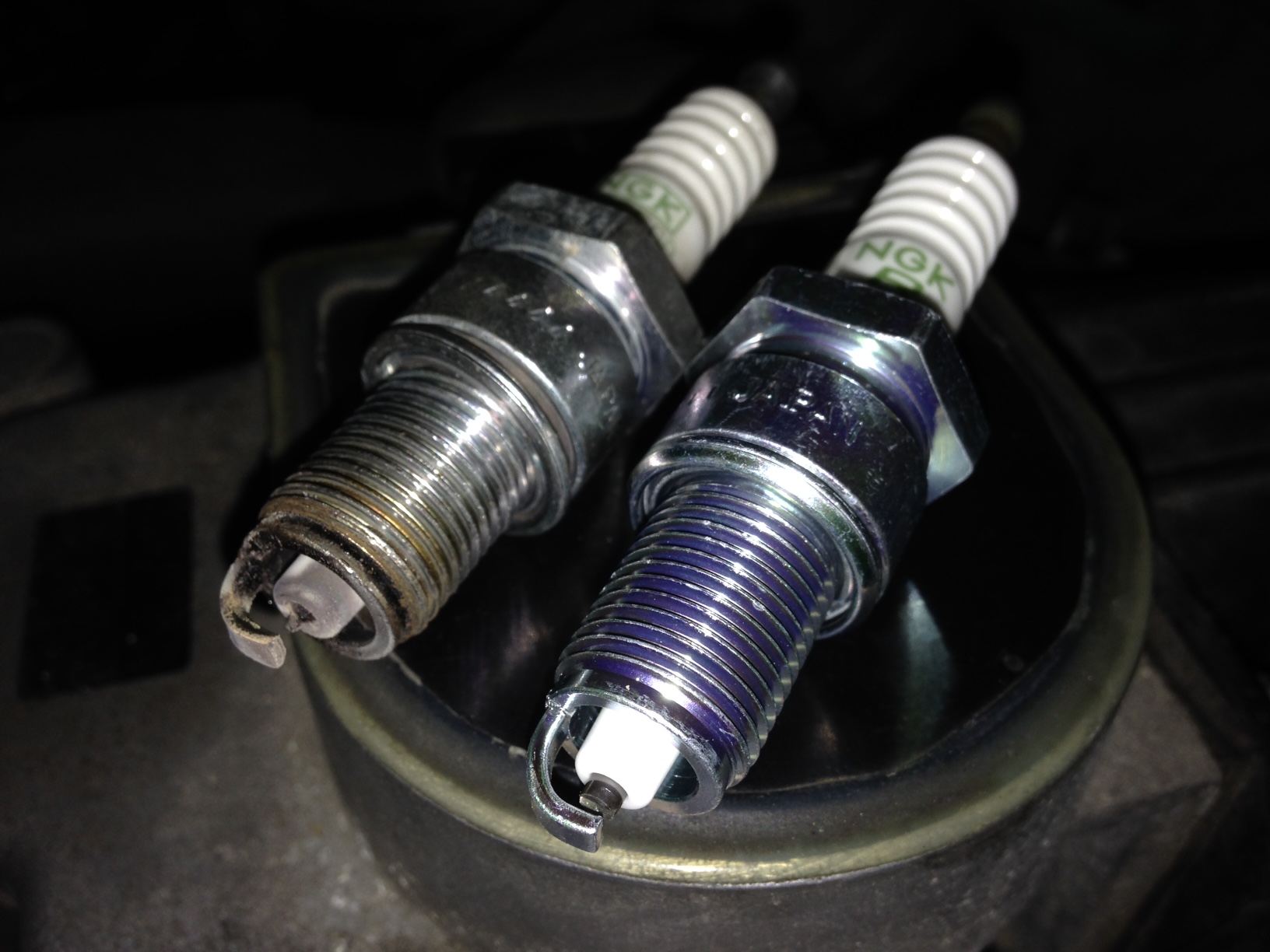

- When I changed plugs 2 weeks ago they looked like this (see attached)
