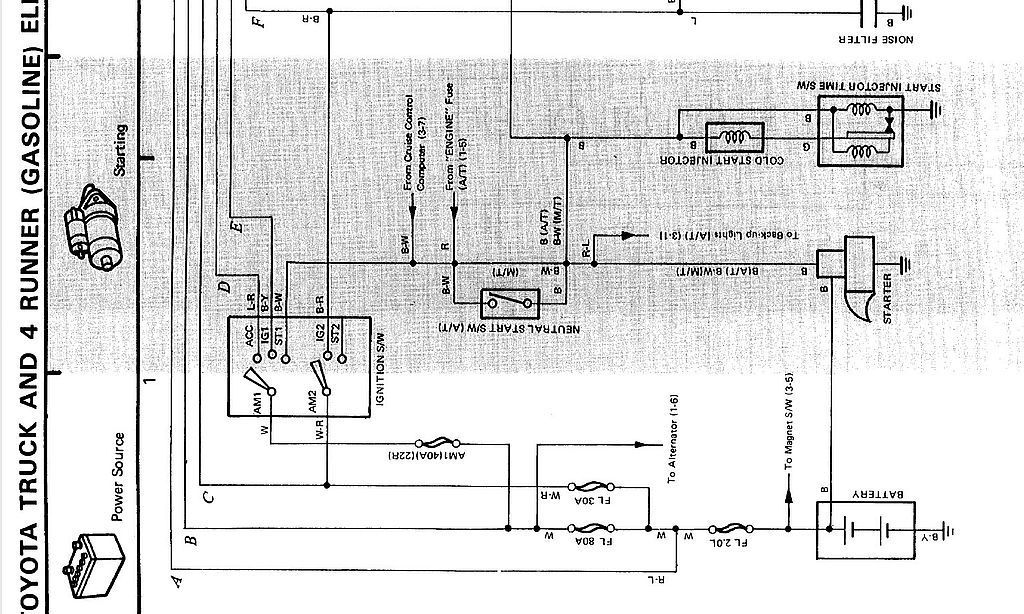

OK, here's the schematic for your year truck's starter system. As you can see, it's a very simple, if poorly designed, system. Easy enough to trouble-shoot, with a decent multimeter.
You said you checked the fuses, so a fair percentage of the system is covered already. If it were me, I'd go to the plug for th key switch. Find the wire that feeds power to the start contact (ST1). In this case, it's the white wire (W) from the 40A fusible link. You can slip the multimeter's positive lead into the plug easily, and check for the +12 from the battery.
If it's there, plug the key-switch plugs back together, and find the wire coming from the key's ST1 contact. In this case, the black wire with the white stripe (B-W). You can slip the meter's lead into the back of the plug, or if it's too fat, like me, you can use the expensive test lead extender. Most people call it a paper clip. Turn the key to start, and see if your +12 is there. If it's not, bad key switch, which is replaceable without replacing the keyed portion.
If it IS there, go on with tracing the voltage down until you get to the starter. I would guess that either the key switch is bad, or the wiring to the starter. Like I said, having the "hot" wire feeding the starter go through the key-switch is a really bad design. The key switch SHOULD control a relay, which controls the high current feeding the starter. That way, you can keep the high-current wires isolated, and much shorter, instead of going from the battery, all the way to the key switch, and then all the way back to the starter. Bad design.
This isn't to say there's not a problem with the starter. Not at all. But these starters are pretty tough. Both mine are still the factory original, and still work great. To verify if it IS, or IS NOT the starter, you can pull the wire off the starter, and check it for voltage when the key is turned to start. It's that single, black wire (auto transmission), or the single BW (black white) wire for manual trannys, that plugs right into the starter solenoid, in the front of it. Easy to check, just place the meter lead into the plug, with it disconnected, and have a friend turn the key to start. Make certain you stand to the side of the truck, the transmission is in neutral, and the transfer case is too. Make sure the parking brake is on too. The starter shouldn't turn with the wire pulled off the solenoid, but hey, why take any chances. You SHOULD see +12 VDC with the key in the start position, and the clutch depressed, the Clutch Cancel switch depressed, on a manual transmission. Or with the gear lever in Park, for an auto transmission vehicle.
Make certain the key switch is in the OFF position before you reconnect the wire to the starter. Check it yourself. Don't take anyone's word for it. Go LOOK for your self. Better yet, pull the key out and put it in your pocket. No way, that way, for anyone to go turn the key on for some reason when you're connecting the wire. When it comes to my precious hide, I don't trust anyone. Not only an the battery voltage bite HARD, the starter could turn by accident, and maybe, just maybe, cause the truck to move. I'm a chicken about things like that.
If the +12 is there, starter, or the starter solenoid, is bad. Not there, you can go start checking the wires, looking for voltage at the key switch, etc. The starter solenoid can be rebuilt with after market kits available online. I've also heard that the contacts in the solenoid can develop a build up of carbon on them, preventing operation. If so, you can just use a small file, or some fine-grit sand paper, to remove the carbon build up.
Given the current flowing through them, I'll wager the contacts in the key switch can develop carbon build up, too. If soo, clean them, and see if it works.

Thanks a bunch Pat the diagram you sent and the explanation is very detailed and was very helpful. Once I get a minute i’ll poke around at the stuff you listed and see if I can get it to turn over.
