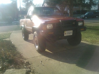

Okay, Got my knuckle service kit, rebuilding hubs this weekend and ordering OME 2" 'system'. My question is this: Heavy or light springs? I have small bumper in front and simple bumper in rear. I plan on mounting a winch and I also have a toolbox. After I get the springs and shocks set up I will be running my 85 with OME suspension 31 0r 32 BFGs and putting ARB air locker in the rear with open dif in the front. Thats for my DD / snow / light offroad. what do you think? and light or heavy?
thanks
JP
Attached Thumbnails 85 22r getting ready to lift-back.jpg   85 22r getting ready to lift-front.jpg
