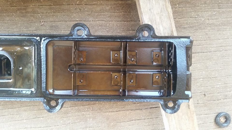

So I just took off the top of the engine and also replaced the oil to see if it was milky or had any water, and found out there was none.
Although I am confused because under the top I did find some milky oil
I took off the other black pan thing with all the bolts on there and found this
Here is what was under it. Only had minimum milk

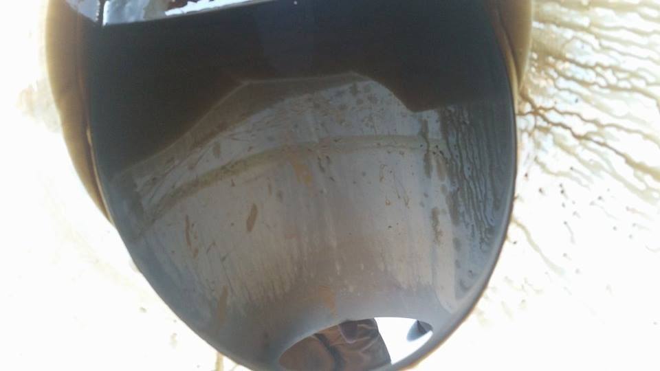

Here is the inside of the engine.
Also I found a pipe that had been crimped and welded off. I believe it was for the water heater.
Here is what happened to the pipes that go to the water heater through the fire wall.

Don't sweat the "milky" oil cap - typically that is just evaporated moisture that rises to the highest point of the engine (the oil cap) and condenses. It mixes with a little oil and gives you some "milk." I have had that happen on my Tundra for years (and over 50,000 miles) now and it hasn't causes me any problems.
It is also pretty much impossible to hook up the cooling hoses wrong on these trucks - the top/passenger side radiator hose goes to the thermostat housing and the lower/driver side radiator hose goes to the water pump (by way of the hardline around the driver side engine mount). So unless you have a radiator hose randomly running across the engine to the wrong side then you should be ok on the routing. The "extra" stuff like the heater core, emissions, etc won't matter. You could have them complete blocked off or routed completely backwards and the engine is still going to circulate coolant through the block.

The reason I'm telling you this is because based on the pictures above, it doesn't look like the engine was ever extremely hot. Unless you know for certain that it was truly over heating, I would try to get a aftermarket or a diagnostic temperature gauge to verify the actual temperature to rule out any possible issues with the factory temperature gauge.
