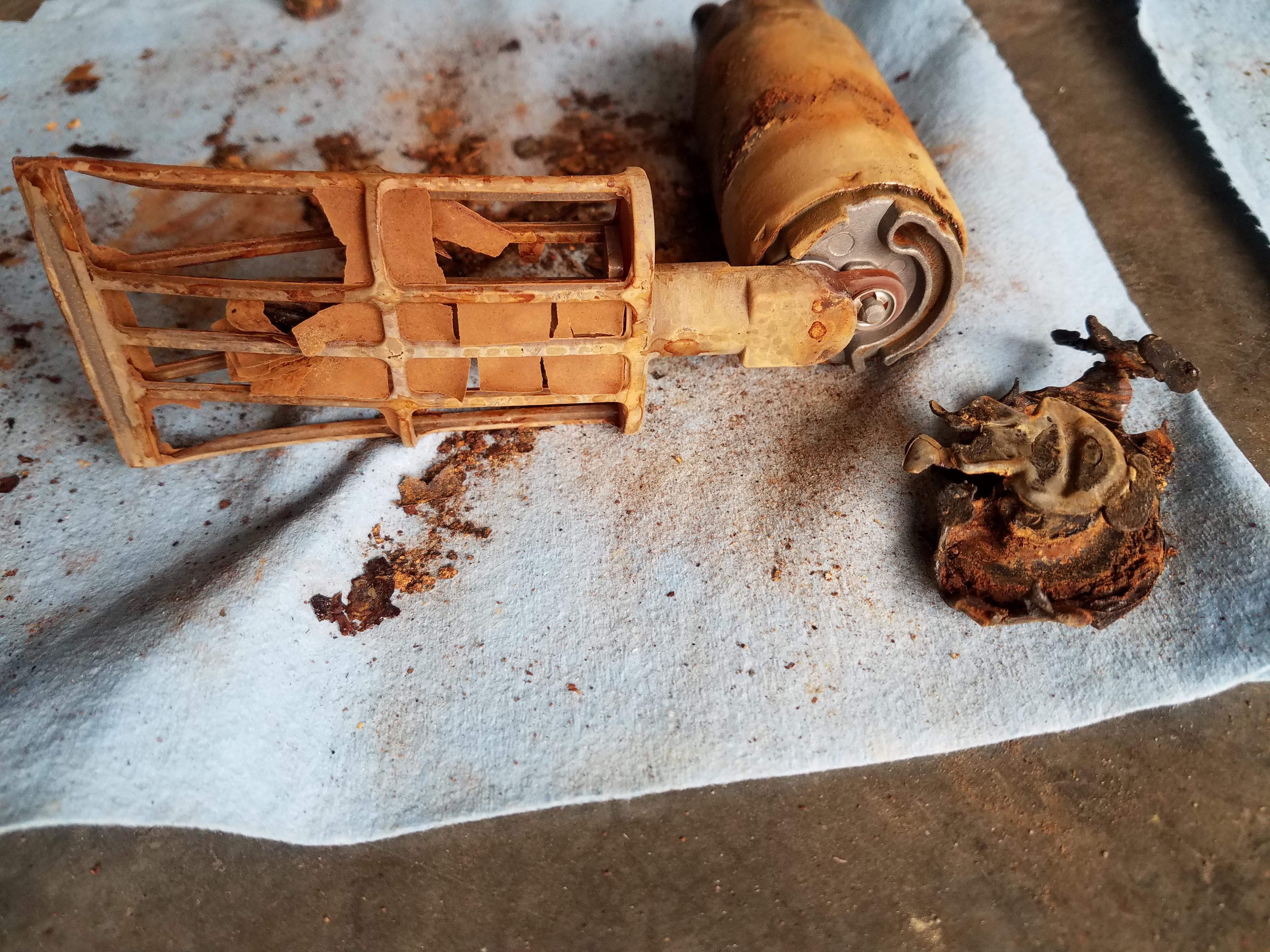

Try pulling the fuel pump. My strainer had disintegrated and ws clogging the fuel pickup, causing very similar issues.

thank you for the response wow that was in bad shape!
