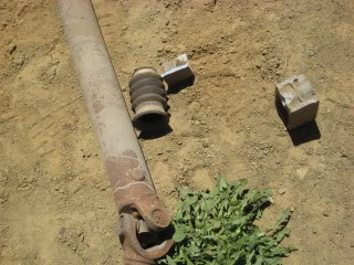

Old May 1, 2014 | 02:59 AM
91 4Runner's Avatar
Joined: Nov 2004
Posts: 868
From: Ameliasburgh, On. Ca.
