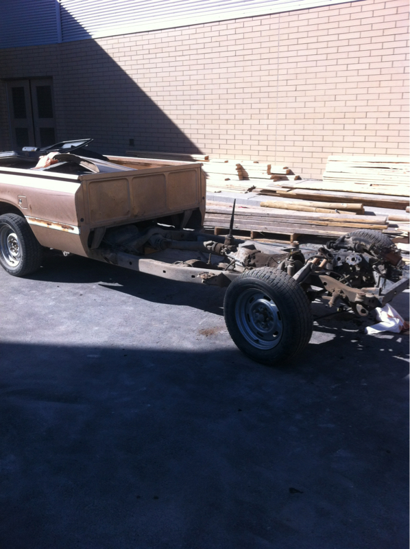

Since this is my last year of high school i really wanted to take advantage of the great shop that my school has. Ive been into toyotas for about two years now and am in a great possition for building them. I work for a company called 4xToys. We are basicly a toyota pickup and 4runner pick-a-part. I managed to grab get a 2wd mojave (rough shape, no motor, slight body damage and rust all over).
I brought it to my school and began to strip it down with intentions of building a simple camper that will match the ride height, colour and body style of my pickup

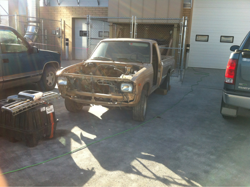

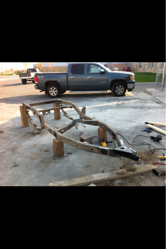

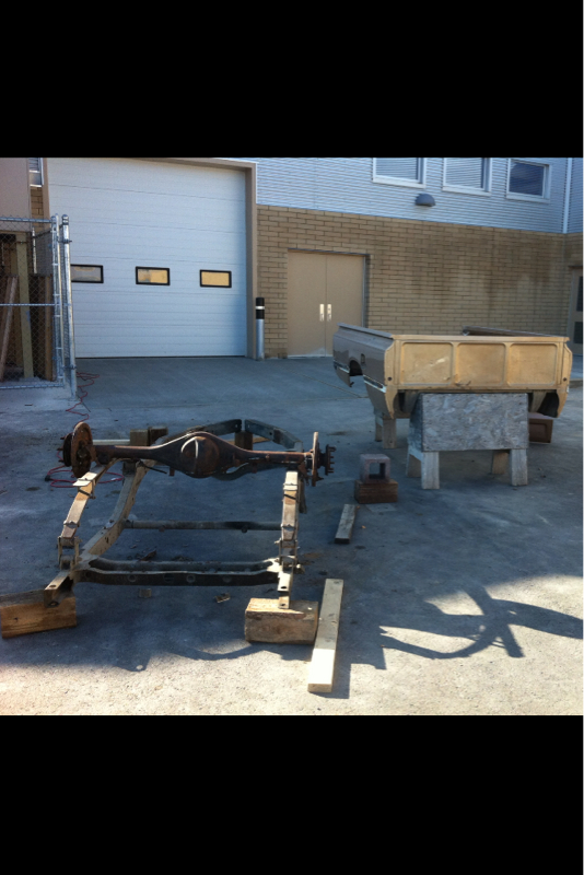

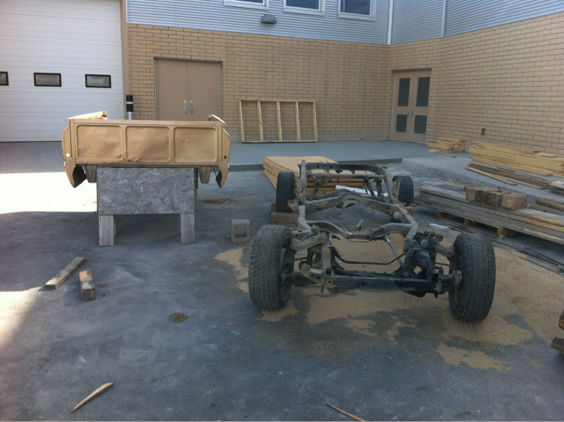

Me and a couple friends had it stripped down to a rolling frame within two classes

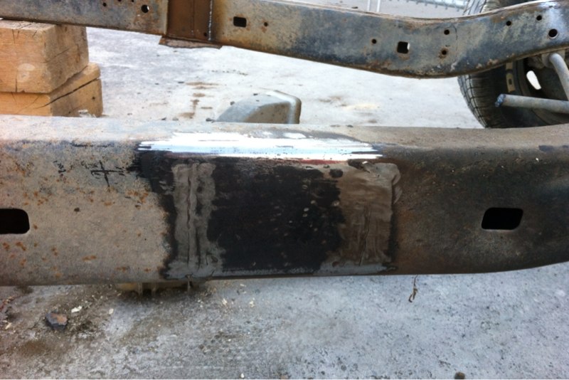

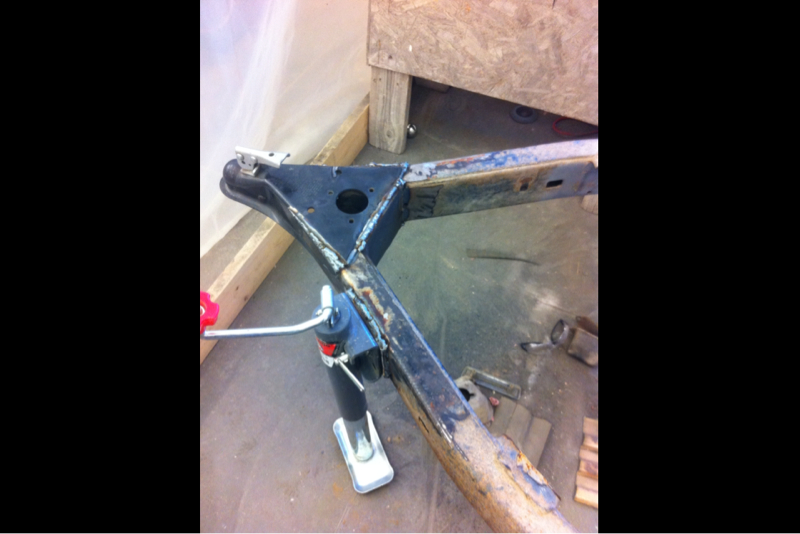

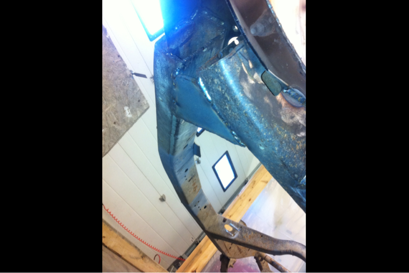

Got a few hours in today. Had two shop classes and i stayed in at lunch. Anyway i started cleaning up the frame. I cut the front out and notched the insides of it so i can fold them together. I also removed the cab mounts. Ofcourse there was rust in them. I cut the rust out and welded in some new plates. I also bought a jack for the front and a weld on hitch plate
Attached Thumbnails 2wd mojave pickup converted to offroad camping trailer-image-3990310749.jpg   2wd mojave pickup converted to offroad camping trailer-image-2157917426.jpg

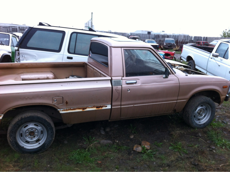

Found this online today. Too bad the one i got was treated to badly.
Attached Thumbnails 2wd mojave pickup converted to offroad camping trailer-image-2628078057.jpg

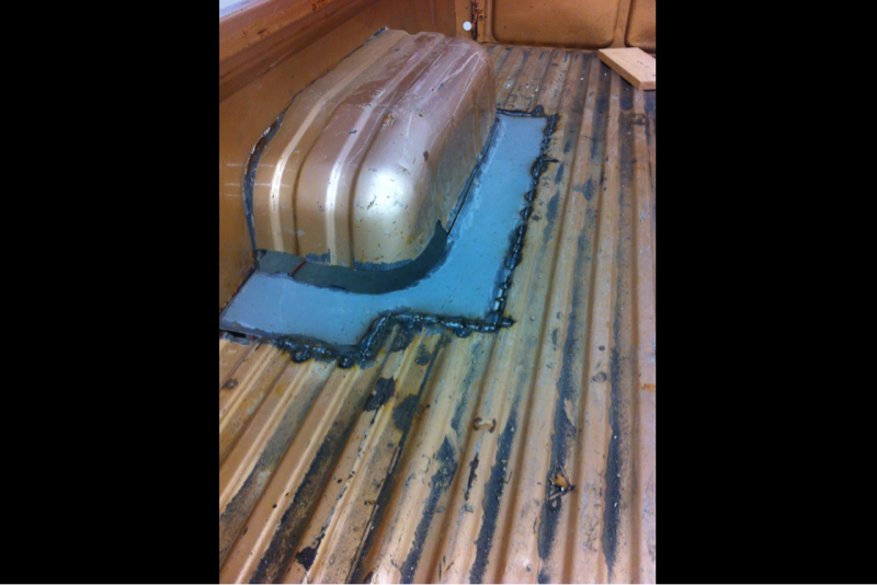

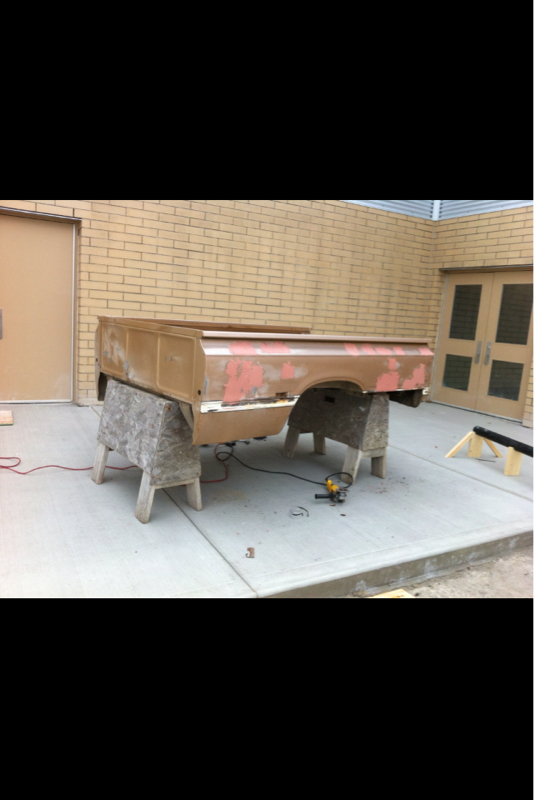

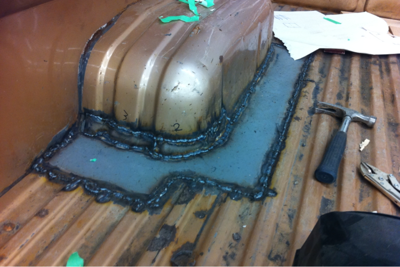

I cut the rust holes out of the bed today and replaced the metal with patches
Attached Thumbnails 2wd mojave pickup converted to offroad camping trailer-image-3581589589.jpg   2wd mojave pickup converted to offroad camping trailer-image-3487474533.jpg

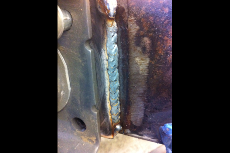

Sorry about the lack of updates. Ive been busy with tests and semester break. But anyways, ive got the frame inside now. I welded on the hitch plate and added some other plates to it for more support. I plan on coverin the triangle front end with sheet metal but i dont have a big enough sheet at the moment. Once the sheet is on i will mount a tool box and spare tire on the front of it. Ive also welded on the jack and saftey chains. Looks like the jack will need an extention.

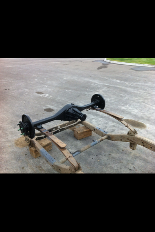

Got the frame cleaned and painted. Its sitting on the diff now. Im have 5" blocks that im using for the lift. If they handle too rough ill just take them out. I had to have custom u bolts made at a brake shop (couldn't find anything for a 5" block haha. I i got the ubolts made round so the plate could go on the top of the spring. I cut the shock tab off the plate with a plasma cutter and welded it to the top of the axle. Im using rancho 5000 shocks. Im likely going to need a sway bar but will do a test camp trip to see what needs to be adjusted, modified or added. My buddy also got the body work done and has the box painted.
