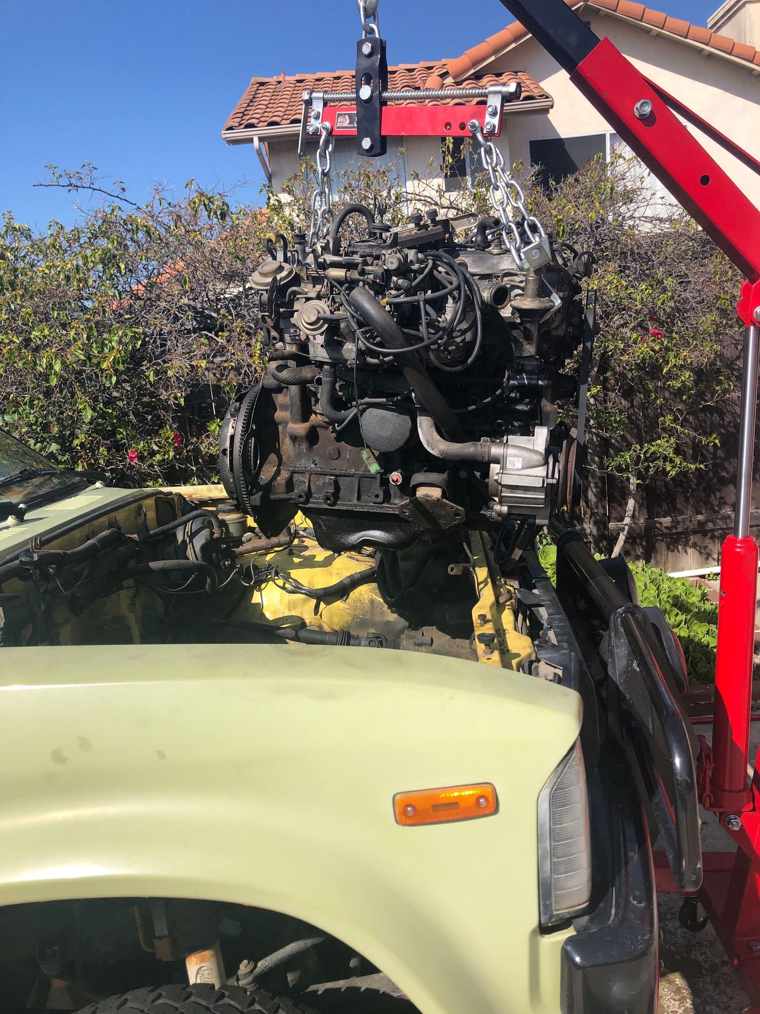

Next step: Finally got around to pulling the motor and transmission from the Hilux. It wasn't bad and I ended up getting it done by myself. I unbolted the motor from the transmission and cherry picking the motor from the front and then dropping the transmission from the bottom.
Had to remove the hood in order to pull out the 22r
Time to say good bye to the tried and true 22R
Hardest thing about this was removing the two bolts all the way in the back, sandwiched between the firewall and the tranny, holding the tranny to motor. Took me a good 40 mins to get the bolts out 1/2 turn at a time!!!

Try an many extensions as you have, i had about 36" of extensions. Its worked for me one time.

This is what has worked for me in the past
