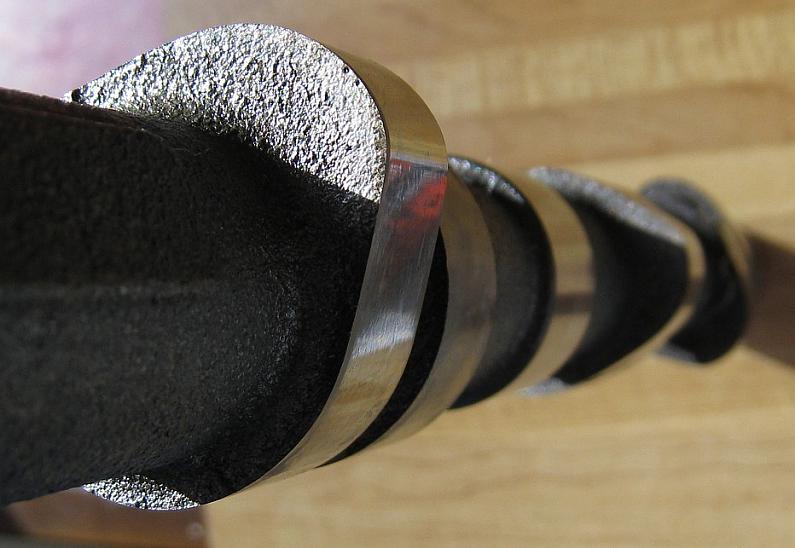

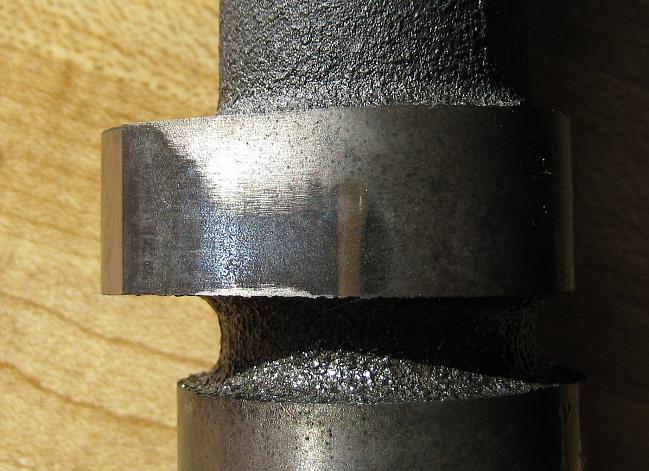

Rebuilding my 89 pickup's 22re that had 200k miles on it, noticed a flat side on all of the cam lobes. Have heard that these motors must be broken in with zinc additive, otherwise this occurs. I think I'm going to replace the camshaft anyway since the journals measured below the minimum allowable dia + the rear journal had a 6/10ths taper on it.
It was hard to capture the profile with the camera, it's not really fully shown in this one how flat it is, but it is definitely flat on one side. I also took a picture to show the wear pattern if that helps.

Go with the engnbldr head with oversized valves , as for the rest of the rebuild kit shy of new head bolts and a water pump engnbldrs comes with just about everything needed to rebuild the motor.
