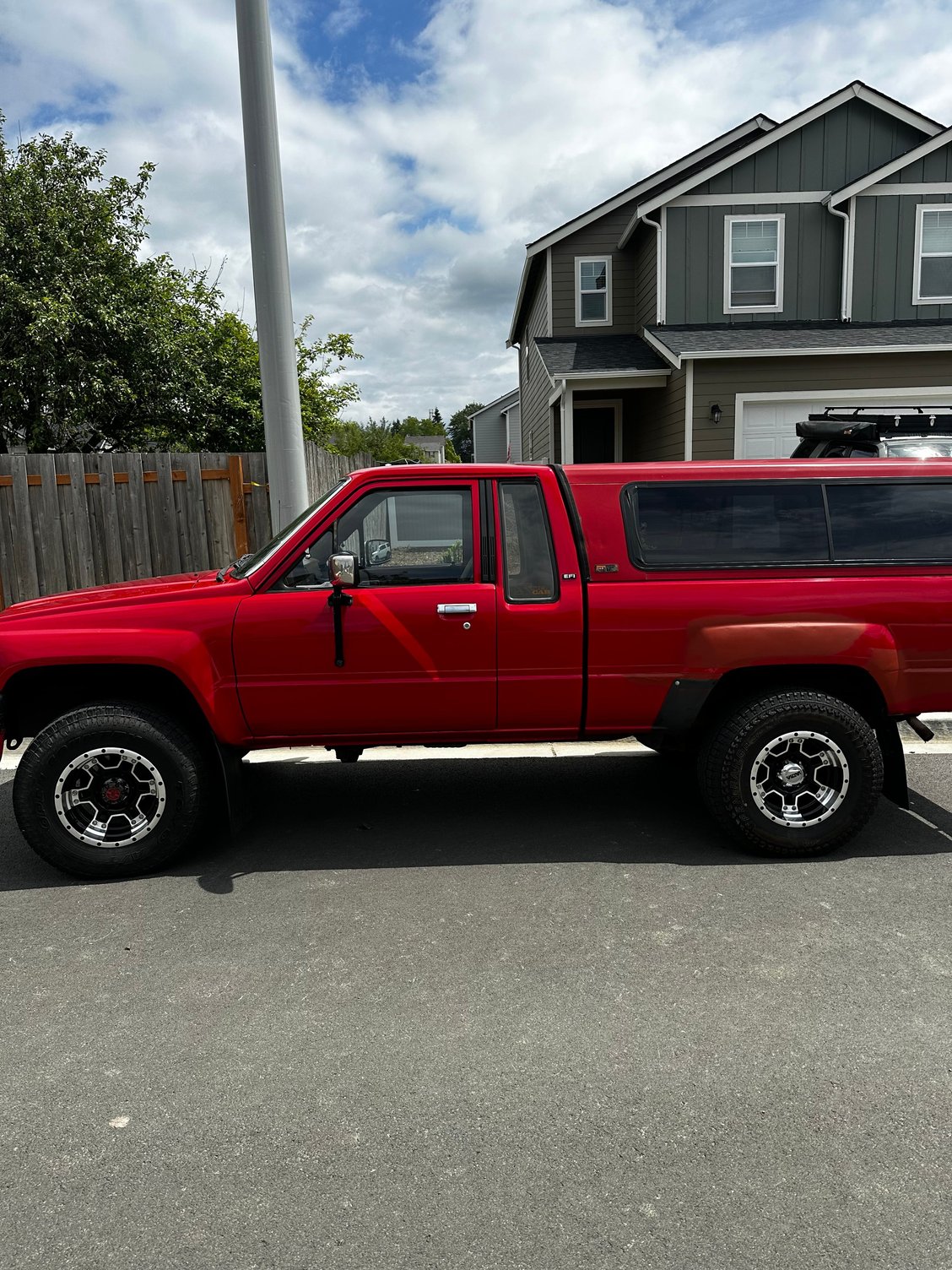

22RE pickup suspension question
I’ve been looking through the inter webs but can’t find the answer. Or I find conflicting information.
Can someone clear this is for me: I have a 1986 pickup I’d like to change the shocks on. I was wondering if I can use 1st and 2nd gen suspension and leaf components on the little pickup? Thank you
Pic for fun and reference.
