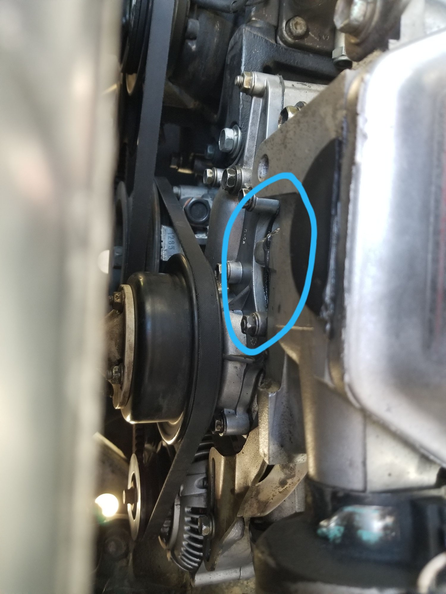

That timing cover and head have been off before.
Tool marks on various nuts and bolts on the water pump in the images, rtv squishing out of the timing cover to head junction as well as on the valve cover over the half moon.

I agree the valve cover and water pump has been off. Possibly the timing cover too. Not so sure the head has been off though.
The radiator has been replaced. And there is rtv around the coolant hoses.
The truck runs so well..... so the only reason to tear it apart would be to fix the leak. It definitely looks like it's coming from the top of the timing cover. Not from the half moon.
Maybe I will pull the valve cover and have a look at the bolt that's supposed to have sealant on it. Is that the one that's hidden in the oil? And the same time I could inspect the guides.

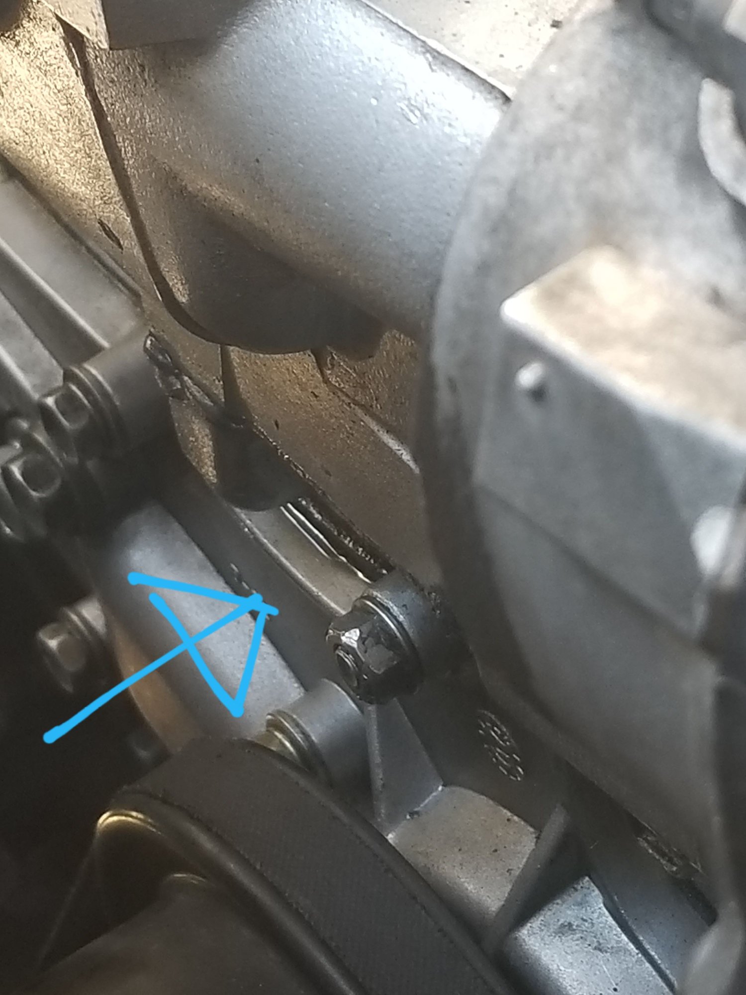

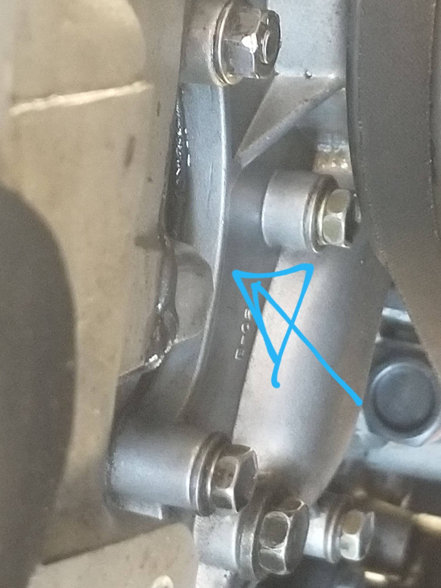

Here is the suspected bolt that is leaking. Needs RTV or something to seal it. I haven't taken off the valve cover yet to see.

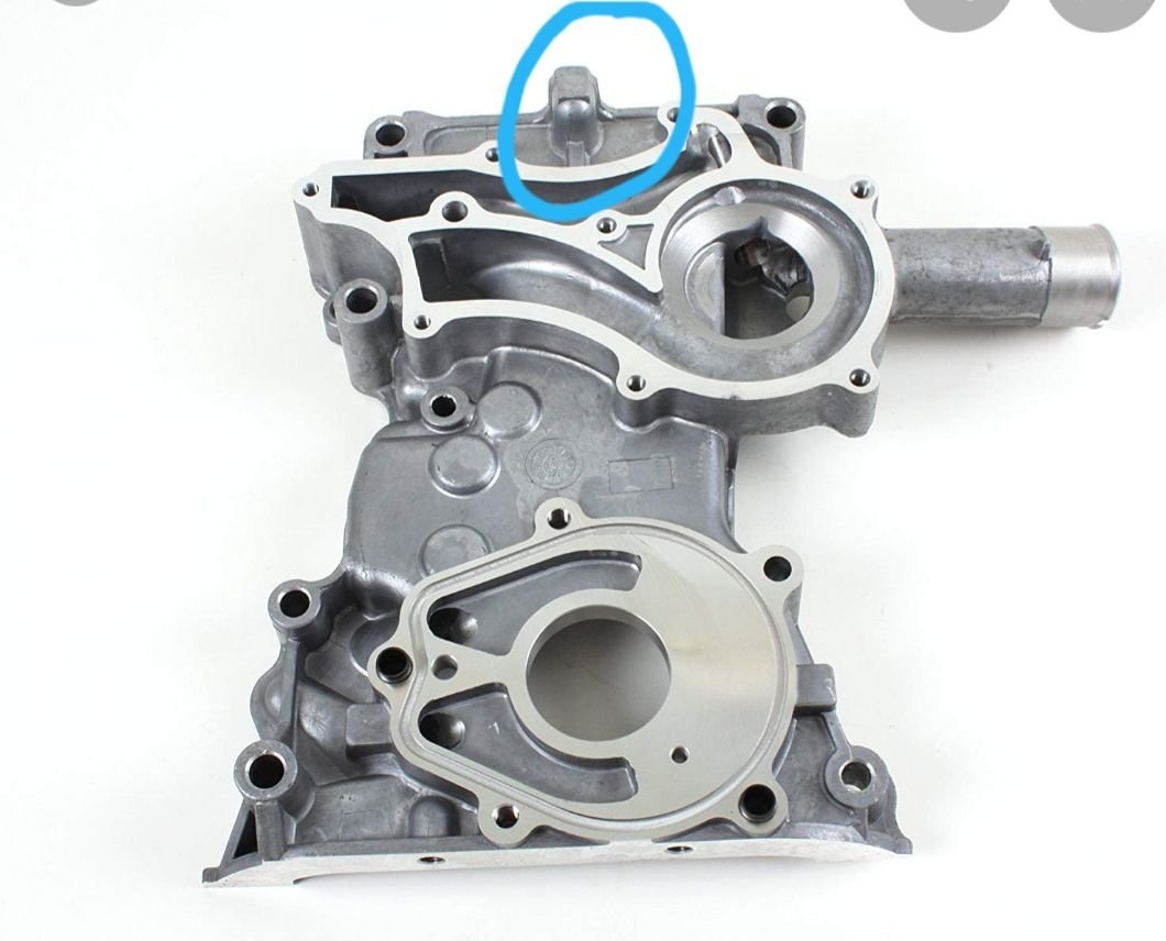

No sealant required for that bolt.
But if someone removed the timing cover without pulling the head and replacing the head gasket, you will be fighting an uphill battle to reseal it. And if the timing cover was replaced and not milled to the block height, again very hard to seal..
I have seen leaks there from a fractured timing cover from someone trying to pry the cover off without undoing that bolt, dropping the oil pan and timing cover to do a Timing chain. Where the cover meet the head and block leaks easily after that if not done perfect. Many others have been mentioned as well.
