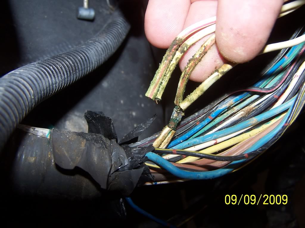

i had similar symptoms, finally cut into the engine harness right around the plastic 90 degree elbow piece, and found corroded connector junctions, in the wires going to the injectors.

Thanks, Im gonna do that tomorow, Nothing to lose. Monday if I dont find it Im gonna limp on down to the mechanic shop and see if they come up with something. You know I talked to toyota and they told me they probably couldnt do any more than I could!! Because it wont hook up to their computer.

Darn, I worked my way through the wiring harness and finally found the splices (almost where the wires go through the fire wall) they were in good condition, shiny copper color and all tight. What Next?
