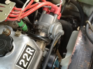

First Toyota truck and first post...been reading for a week or so.
New plugs, wires, rotor and cap. Valves adjusted and all cylinders compression between 161 and 171.
Started with stock 8 deg advance and took it for a test drive. Felt weak and lots of flat spots in the power curve.
http://www.racetep.com/webjettune.html
Says "Generally speaking you need a little more advance with a Weber than with the stock carb. A good place to start for most cars with Webers on pump gas is 12-14 Degrees advance at 1000 RPM idle and 36 Degrees total advance by 3000 RPM...This is not cast in stone and you need to make sure your car does not Detonate at these setting. If you get any detonation then you need to back off the timing"
Working my way up to 18 degrees, power gets better and smoother. Stopped advancing at 20 degrees with power still getting stronger.
How far can I (should I) advance? Does the 22R ping (detonate) in an obvious way??
Vacuum advance is to outer diaphragm and off the carburetor port.

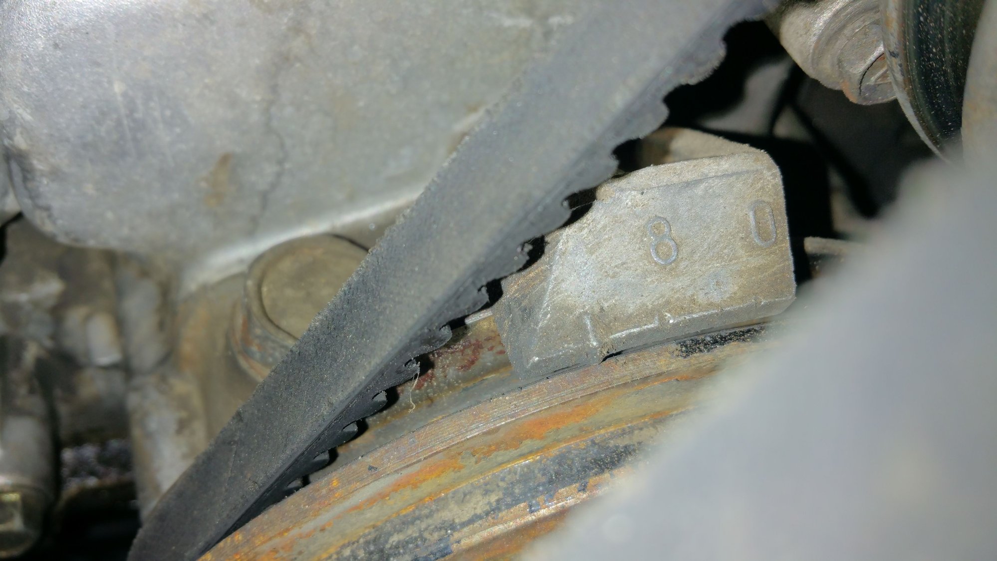

Ignition timing advance need help
Ok I'm coming in a little late s let's hope someone reads this iv got a 1980 20r with a weber 32 36 and my timing is a test 8 btdc iv read that with the weber I should advice the timing up to the 10 to 14 range and a total timing of 28 to 32 the timing plate on my motor only has a 8 and a 0 on it and dose not Have a bunch of degree marks on it so how do I no what range I'm in <br >
