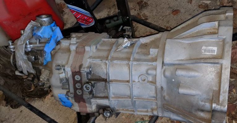

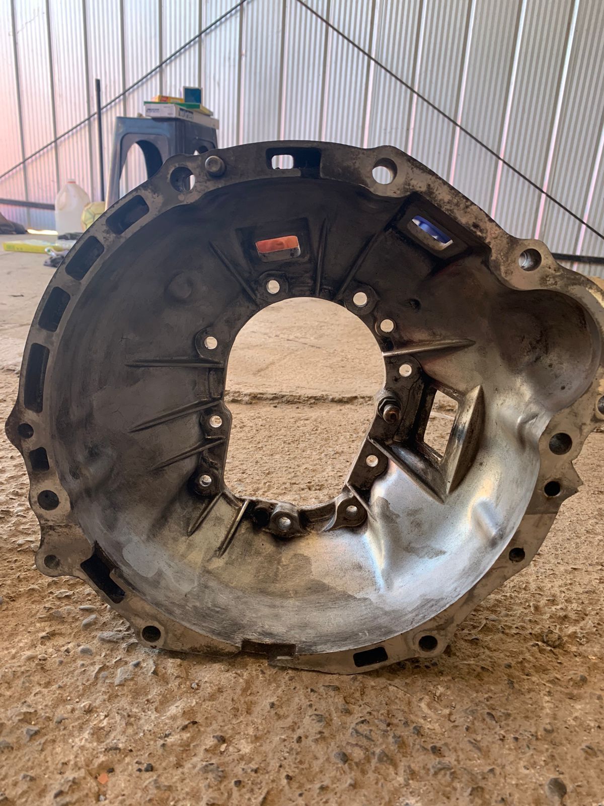

So it has finally arrived! I bought from amayama.com the 31111-26073 bellhousing, also known as the bellhousing for 2TR-FE engine.
This was my only option as I couldn't find it locally in a junkyard, and here it almost never sells standalone from the transmission.
It's a perfect fit, we will mount it soon and I will update this topic if I encounter with any issues.
R156 with bellhousing
R156 without bellhousing
R156 bellhousing - W56 bellhousing - 31111-26073 bellhousing
From top to bottom.
W56 bellhousing
R156 bellhousing
R156 bellhousing
W56 bellhousing
31111-26073 bellhousing - W56 bellhousing - R156 bellhousing

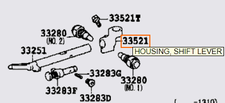

About the parts from the 2011 TOYOTA TACOMA (TRN220L-TRMDKA).
I decided to give it a last try by ordering directly from Toyota USA at https://parts.toyota.com.
They had them in stock and took less than 48 hours to ship them! They only ship within USA so I'm glad I have a friend over there who can act as a proxy to ship them to Chile.
I've bought the following parts:
1 HOUSING, SHIFT LEVER 3352135390
1 CAP, SHIFT LEVER 3355404040
1 BOOT, SHIFT LEVER 3355504040
1 RETAINER SUB-ASSEMBLY, CONTROL SHIFT LEVER (FOR FLOOR SHIFT) 3357035100
1 GASKET 3358471010
1 GASKET; PLUG; SEAT 9034112008
1 PLUG 9093003075
6 BOLT 91611B0825
Those are the final parts needed to finish this swap, as soon as I get them I will update again.

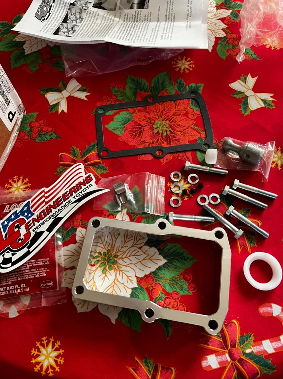

Old Apr 23, 2022 | 02:58 PM
Akurasix's Avatar
Joined: Feb 2022
Posts: 19
Parts arrived, it looks like everything will fit.
Some quick photos for now, progress will start on Monday.

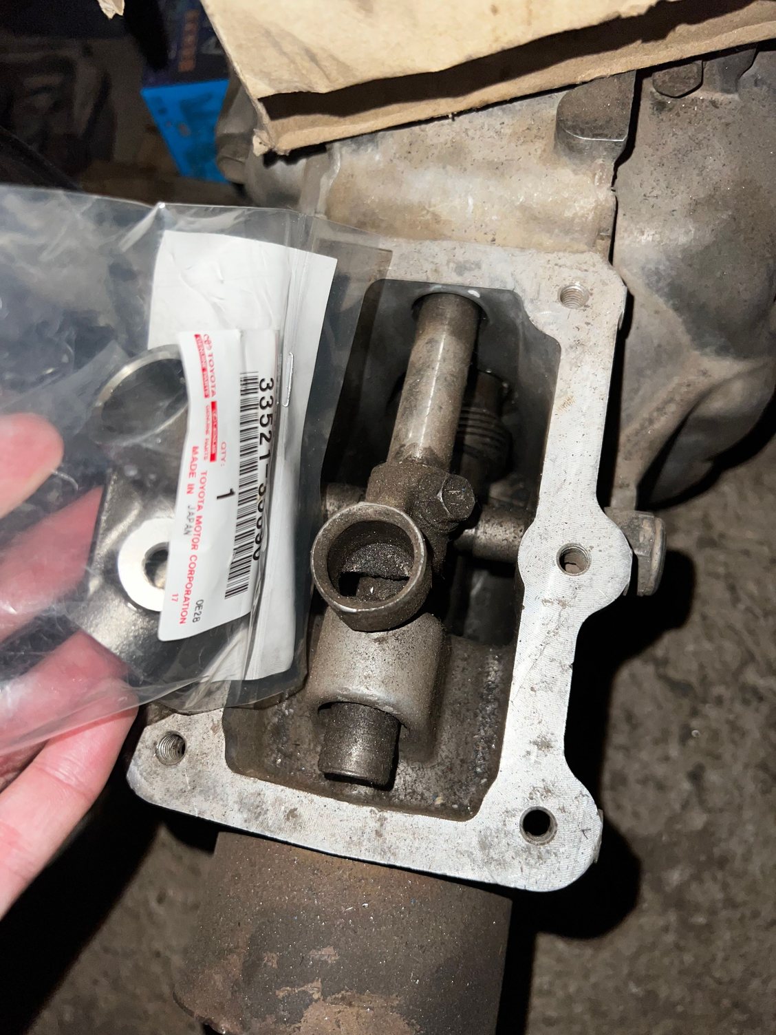

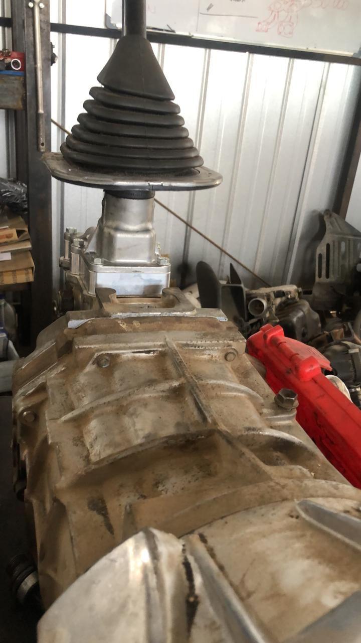

Parts installed successfully! I wasn't able to see the installation myself but the mechanics told me everything was a perfect fit and sent me a picture.
So now I have a 2013 Toyota Hilux R156 with 2011 Toyota Tacoma R155 housing shift lever parts with a short shifter with a 2000 Hilux W56 lever assembly.
Transmission will be probably mounted tomorrow.

To the left, R156 with original shift lever (arm) parts. To the right, R156 with R155 shift lever (arm) parts.
