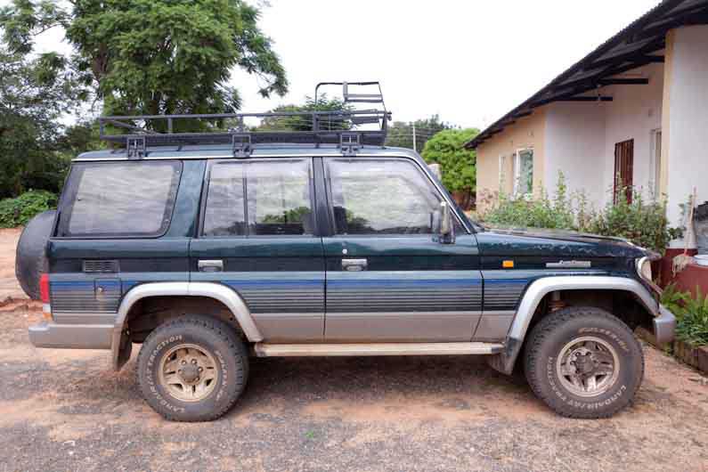

I have attached a picture of the Prado.
Biggest failings of this truck:
- Stupid Auto Electric Hub Locks which have long failed. Currently making spacer brackets to allow AISIN manual hubs.
- Open front and rear diffs (there was an option for LSD and Locker rear but Japanese soccer mums don't really need it).
Found the problem with the combination of these failings the hard way when stuck in Chobe National Park in the sand with just one rear wheel spinning Trying to open and manually lock the front hubs in the sand whilst looking out for lions and elephants on a 40 degree celcius day wasn't much fun
Modifications:
- 2" Ironman Lift Kit (KZJ78 has front and rear coils)
- (very soon) Manual Hub Lock Conversion
- (very soon) Aussie Locker Rear Diff

Thank you for the picture! I can't compare any of my stuck situations with that. Thats pretty scary having to look out for lions and elephants. Good luck! and let us know what happens!
