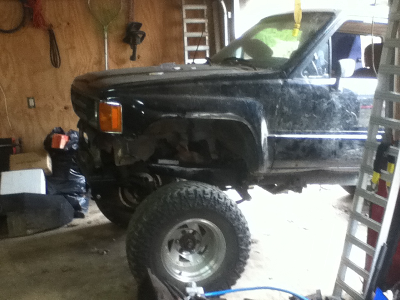

I have an 86 4runner that I did a solid axel swap on.... I bought a matching set of axels out of an 83 Toyota truck .... My 1st question is can I pull the center section out of the 83 rear axel and stick it in my 86 rear end with no issues... Here's my second question... Do I even have to do it? My 4runner came stock with 4.30 gears.... The truck axels ring gear says they are 4.375 gears....sooooo are they the same and just playing a numbers game like chevy does with their " 350 " small block that is actually like 348.7 or something like that
Getting close to being a finished product
