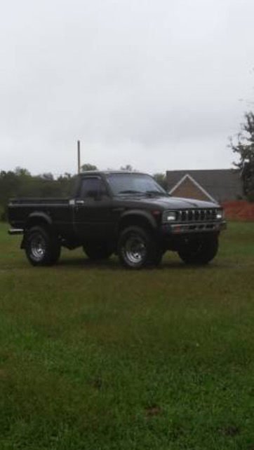

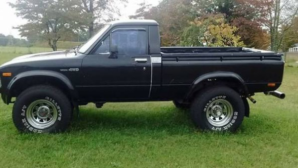

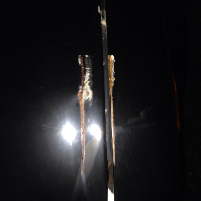

I just purchased a 1983 Toyota 4x4 with a broke crank. So bought a rebuild motor bored 20 over. Got new radiator, water pump, plugs, distributer, starter, hoses, wires, clutch and pressure plate. Truck was a stock one owner truck with every option besides moon roof, 170000 miles. Not all rusted out and hasn't been dogged is the real reason I got it. The only rust is on the front fender( in pic three ) also 6 inch scratch on hood. Going to put a 3 inch lift 33/1350/r15 on aluminum 15x10s. What size axel gears should I get? Can you supply a website? Where can I get a new gauge cluster with 0 miles so I can keep up with everything?

5.29 gears. Source- trail-gear, Marlin Crawler, East coast gear etc

You're going to want 4.88 or 5.29 gears to turn those tires - I would lean more towards 5.29's if you plan on going with those fat 33's and wide wheels.
