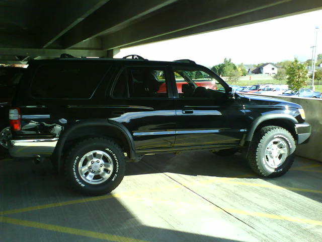

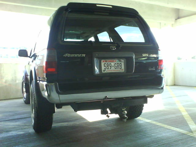

Any pics of a stock 3rd gen with 265/75/16s

Old Jun 3, 2010 | 11:25 AM
badattitude's Avatar
Posts: 282
From: Madison, WI
My sig shows my 1999 with 265/75/16. But I have the stock "tall" spings, I think. I've rubbed once when going into a steep parking lot too fast.
I have a friend that runs the 265/75/16 BFG All Terrains on his 2001 4runner, even has the running boards on it still. I can tell his tires are closer to the fender but I never heard him say they rub. He does complain about the VSC all the time however He does light off roading and the 265/75 are ok. They will look bigger of course.

Would you happen to have a
the pic that you used for your avatar
Old Jun 3, 2010 | 12:39 PM
Posts: 282
From: Madison, WI
Pics
Yes, I'm trying to attach them. We'll see if it works....
00 Limited w  265/75/16s?-4run2.jpg
00 Limited w  265/75/16s?-4run3.jpg
