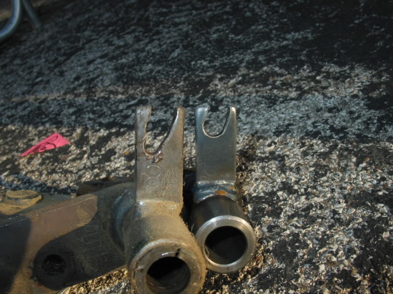

Sometimes it's more than a little adjustment...spring and clutch pedal eat each other over time....
The spring
The Clutch Pedal
Dunno if they're still available, but I got the replacements from Toyota.
