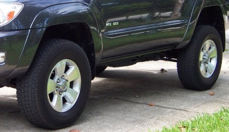

I have that set up. Like it for my needs.
Have them fit up a 285 and test in on the front. That's the place your rub.
It's off most around 60+. I add 3mph to get an idea. I get gas every 3 weeks.
Attached Thumbnails What tires for 04 4runner w/ 3" Revtek Lift?-12.jpg
