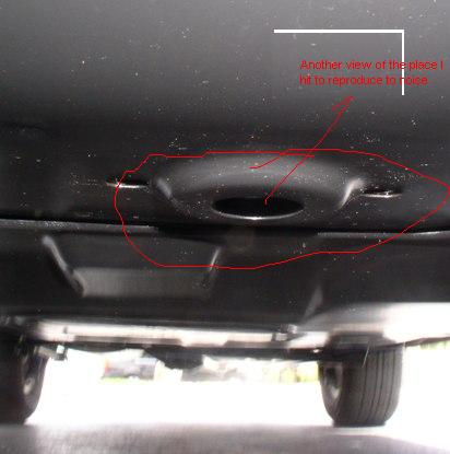

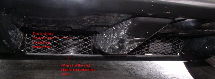

Originally Posted by Yosmany
Does anyone elses skid plate clank with the frame? It's going to be right at the end of the skid plate, where the two lips for bolts come out at.
I am getting a loud clank from my front skidplate. See pics. You said the one on yours was the middle one right? Mine is the front skid but is doing a similar thing or at least it sounds like it......All bolts are GNT.....
Any one have the tsb detals?
