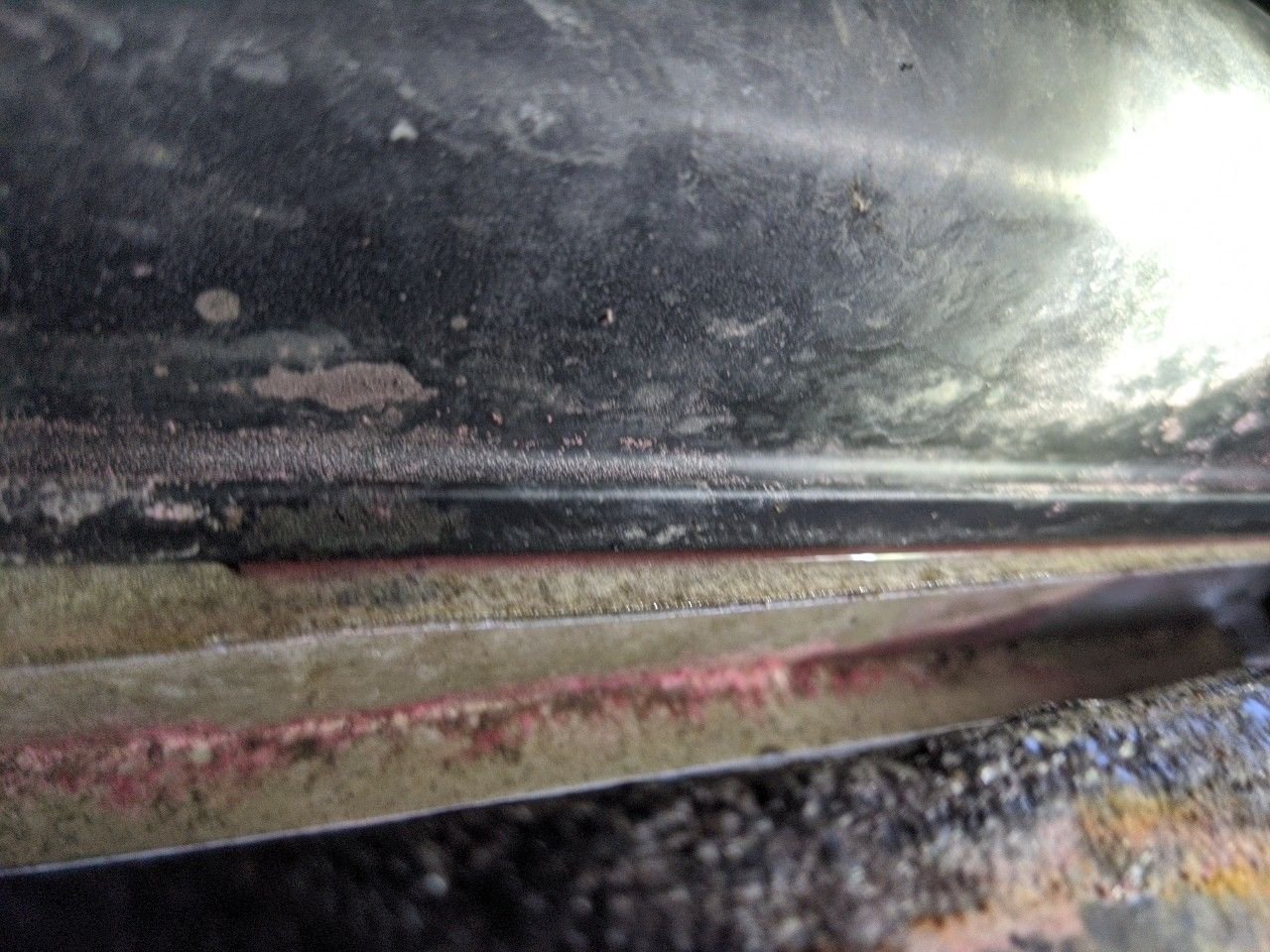

Did a little more checking. I saw one drop hanging off the bottom of radiator (passenger side). Removed skid plate and cannot see anything too obvious - radiator hoses are dry at connections. However, I do see a little seepage along the bottom edge of radiator where it meets bottom of shrowd. So I would assume this would mean the radiator itself would be leaking from some point. The vehicle has 333,800 km (207,000 mi). Would this be typical lifespan for this radiator? Actually, let me see if I can get a picture to add here... not a great picture but you can see along the bottom edge of the black (shrowd) where coolant is evident.
