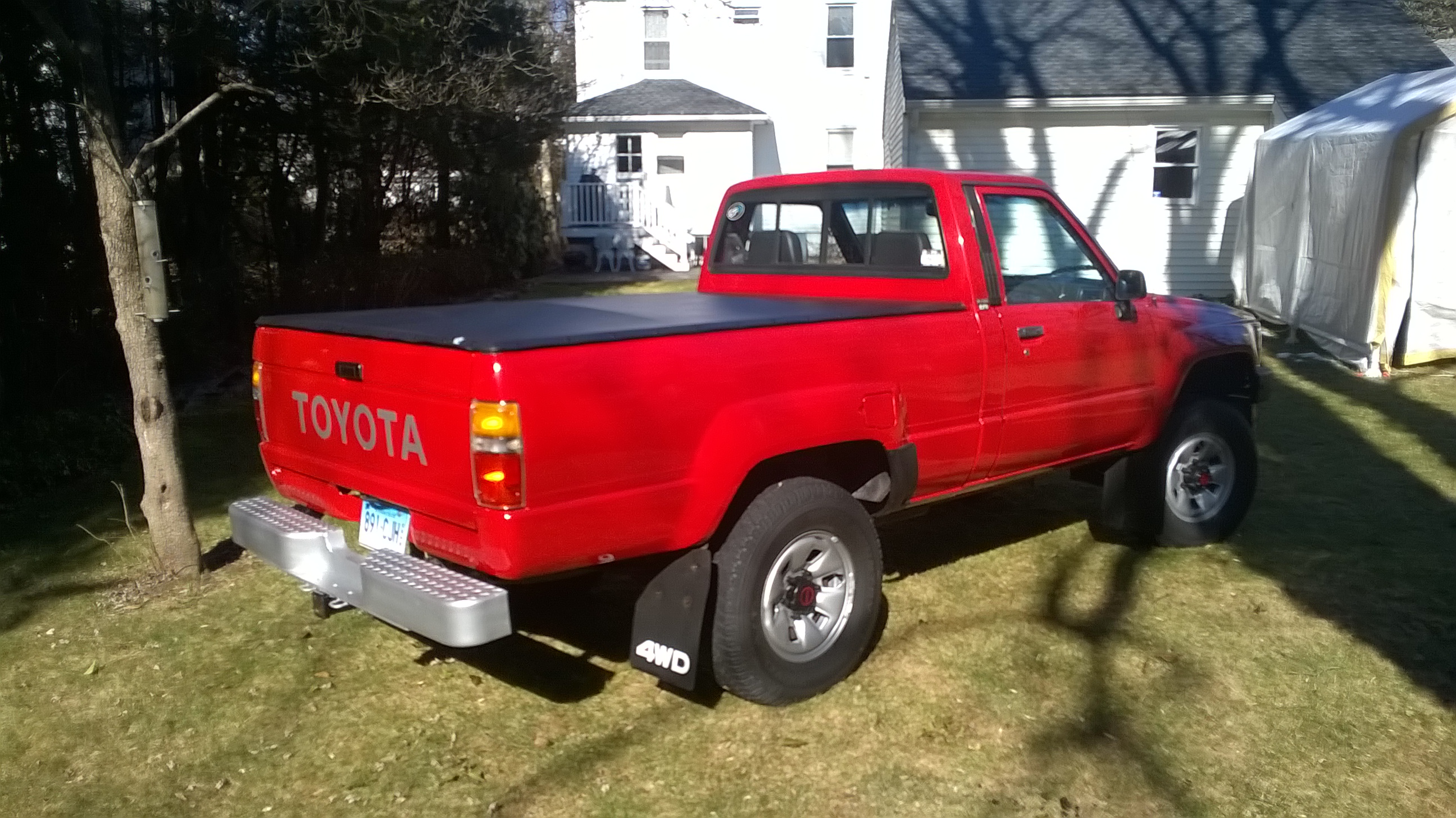

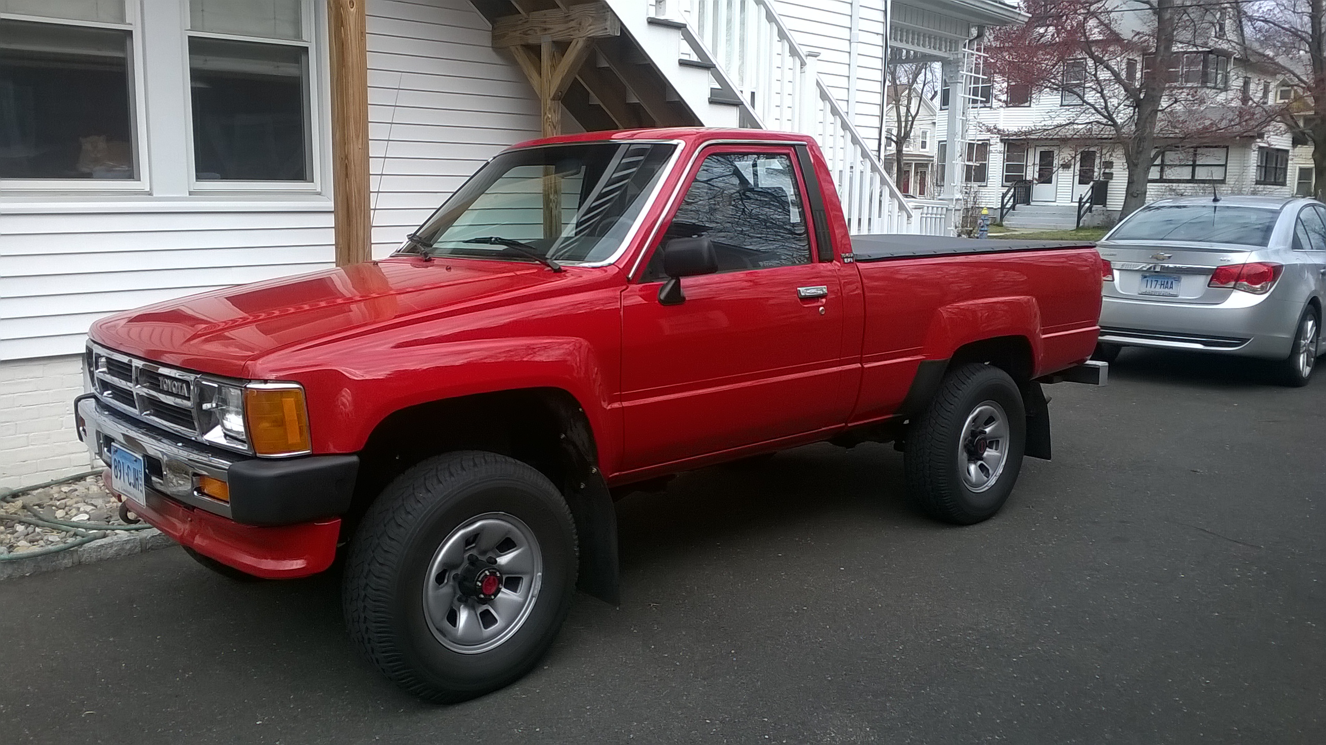

I am the sole owner of this 88 4x4, and looking for opinions regarding if/when it's time to pull the motor and "freshen". Pics taken last fall after a respray. I've babied this it's whole life. Currently 320,000 on the clock, and I've done all the service since day one. Religious fluid changes it whole life. Leaks nothing, burns zero oil. Original clutch (yes, original clutch). Only major service was a head gasket at 180,000. Replaced timing chain at same time since I had it open (original chain was nearly perfect). My goal is 500,000.
