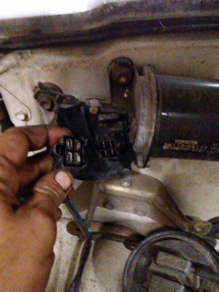

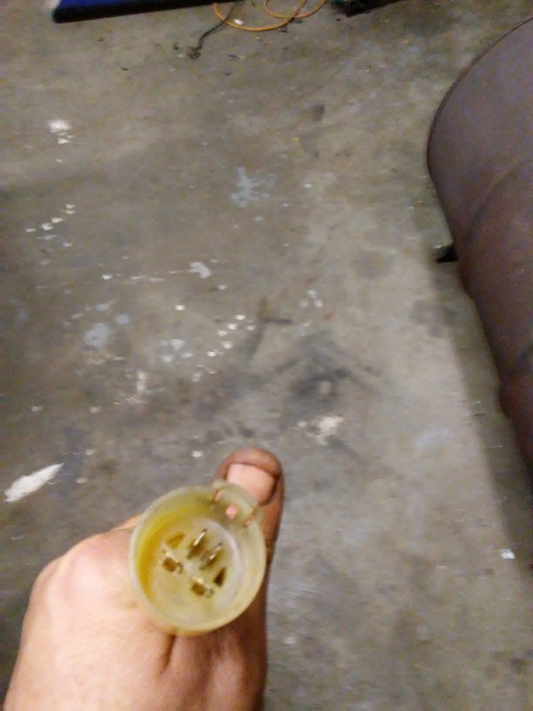

86 and older is the round plug, 88 is the square plug, I think the 87 is a square plug but could be wrong. The motors are the same but you will need the correct plug and Toyota did change the wiring color on two of the wires from square plug to the round plug and dont know which two wires were switched. There may be other models that interchange but I dont know about that.

Oddly, my motor has the square plug rather than the round one like an '86 apparently should have.

I may have my years in correct, but I do know of the 2 different plug connectors on the wiper. I am sure if you posted a Want Ad, someone has one laying around. I would make sure you post the plug that you need for yours in a picture as some may not be aware of the 2 different plugs. I have worked different years of trucks and know about them. Someone with only one truck may not know of the plug differences.

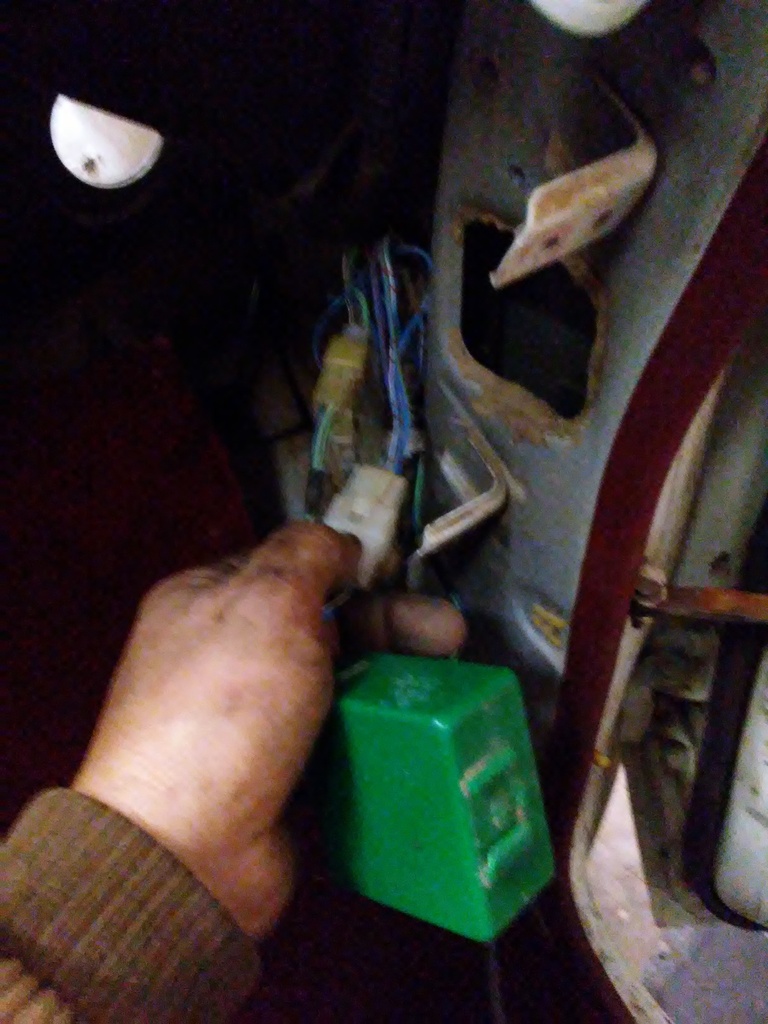

I dont know if your has the Wiper Delay option but one problem I have experienced with wipers and dont remember if the Wipers or the Delay feature would not work. On the passenger kick panel, there is a green box for the Delay option. The green box is mounted in the A pillar, one quick check you can do is to pull the green box off of the pillar and see if the back side of the box is melted. I have seen that a few times working on these trucks.
Below is the green box I was working on today and to show where it is at.
Copied....

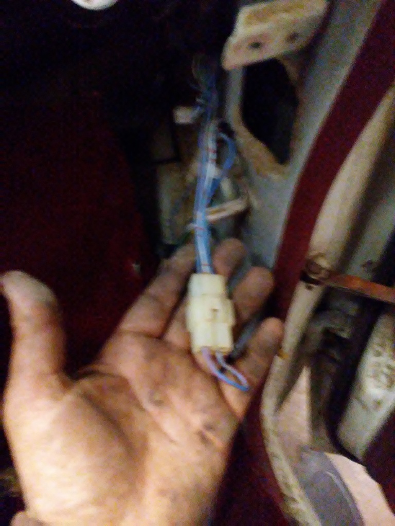

The harness I am installing did not have Wiper Delay installed on it. I have installed Wiper Delay in other trucks. It has been a while since I have done it but if I recall correctly all you need is the Wiper Stalk on the Steering Column and the Wiper Delay boxand Wiper Delay Harness in the passenger kick panel.
In the Passenger Kick Panel, if you have this jumper installed, your truck does not have the Wiper Delay.

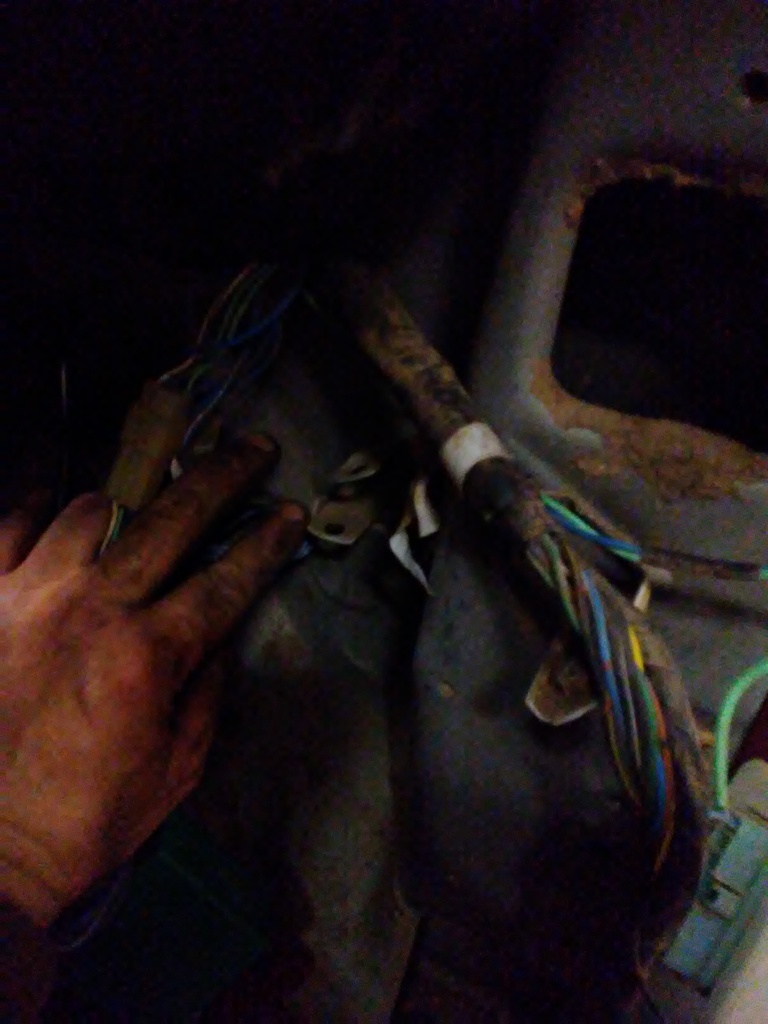

Remove the jumper and connect the Wiper Harness to the Wiper Delay box. One end of the harness will go where the factory jumper was at and there is another plug that is taped up from the factory tucked up inside with the rest of the Main Harness. You will need to get the Stalk for the Steering Column.

Where my finger is pointing is where the top of the Wiper Delay box mounts inside the A Pillar. On EFI trucks you will need to remove the computer to access the mounting tab.
