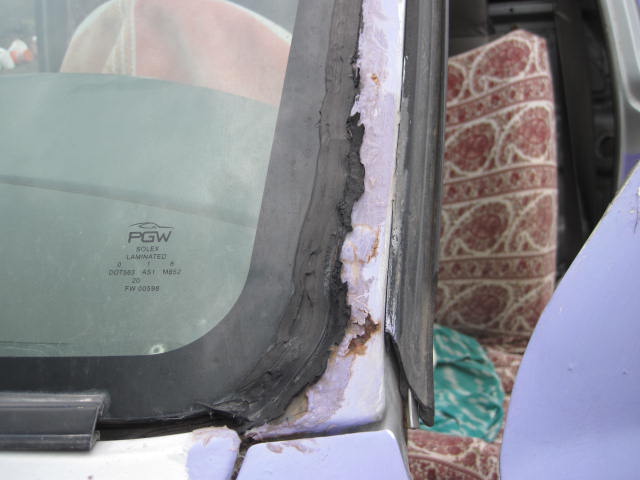

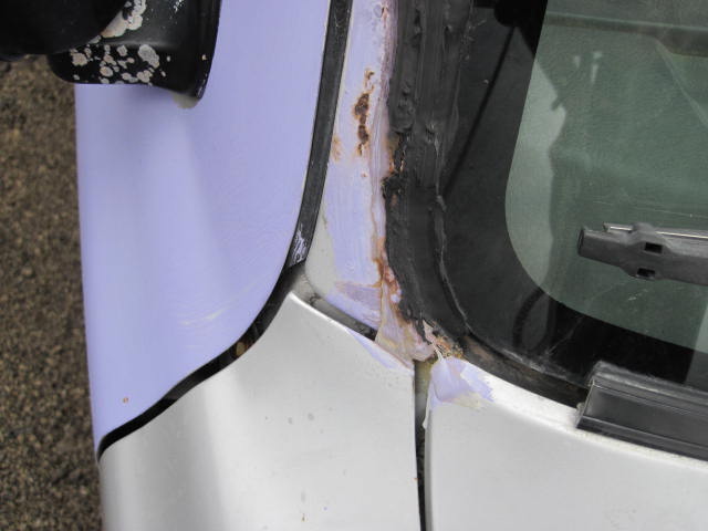

I need to repair my window frame, water is coming into the cab, I want to do a quick fix, I know its bad but I plan on getting a new(used) truck in the near future, any how I dont want to invest a lot of time into it, my plan is to protect the windshield, strip out the rust, treat it then urethane the gap, my question lies in the treating of the rust, what could I treat it with that will accept the urethane?

I would like to post some pics,I am a bit confused, usually my gallery opens but this url biz gots me?
Old Nov 11, 2012 | 08:48 PM
rubronthroad's Avatar
Joined: May 2011
Posts: 312
From: Hawaii
here we are
I figgered it out , doh
Attached Thumbnails windshield repair, what to use on rust?-img_1736.jpg   windshield repair, what to use on rust?-img_1737.jpg   windshield repair, what to use on rust?-img_1739.jpg

Just getting to know my way around this forum is all. Any advise on my windowframe?
