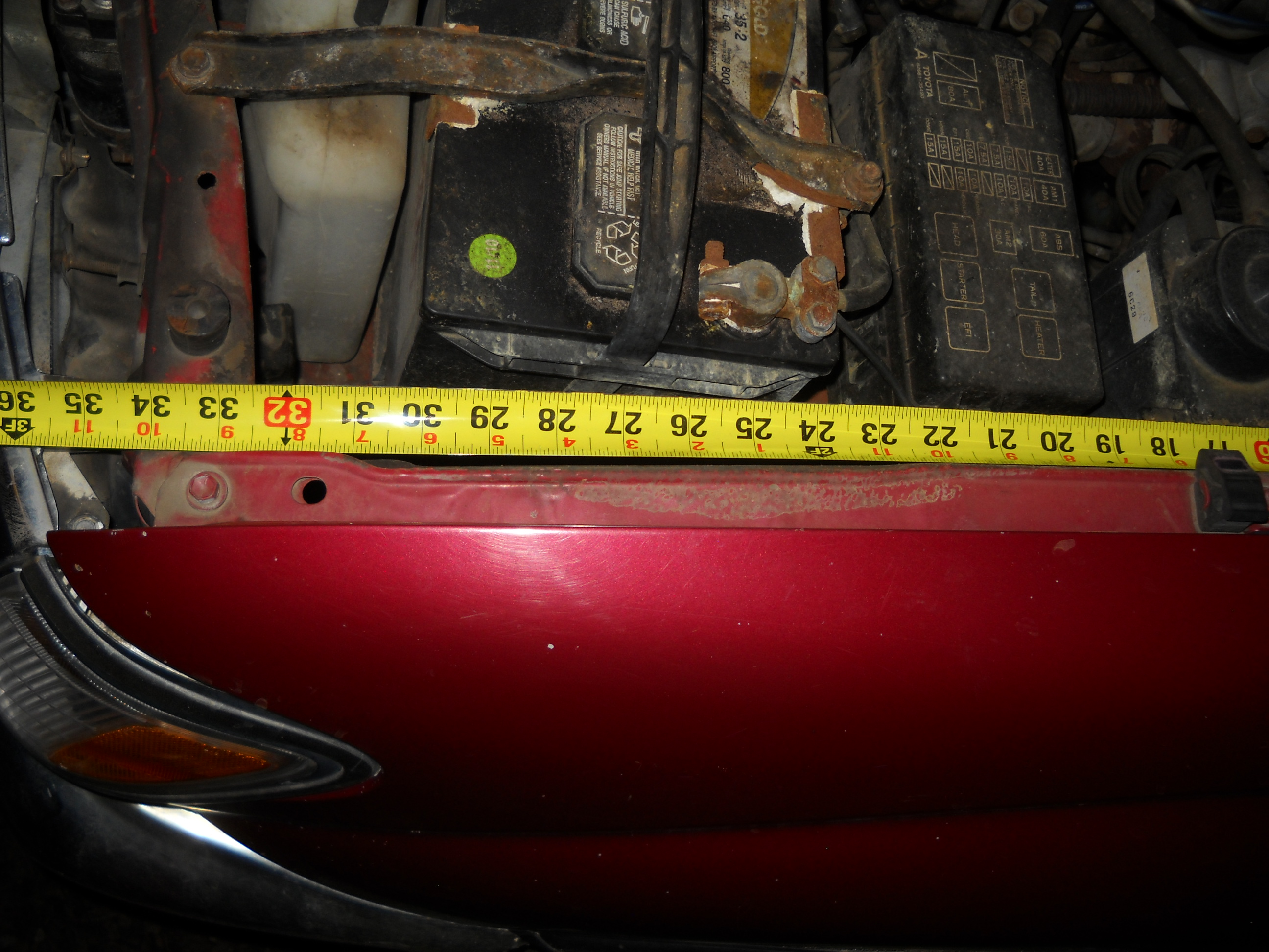

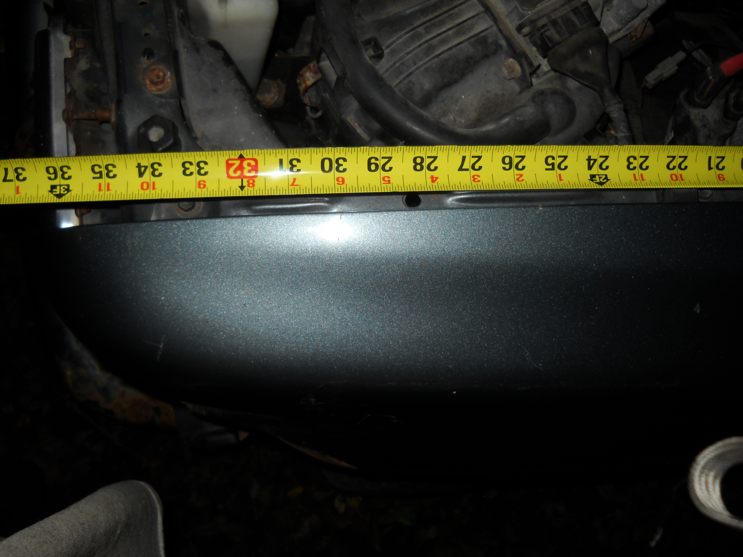

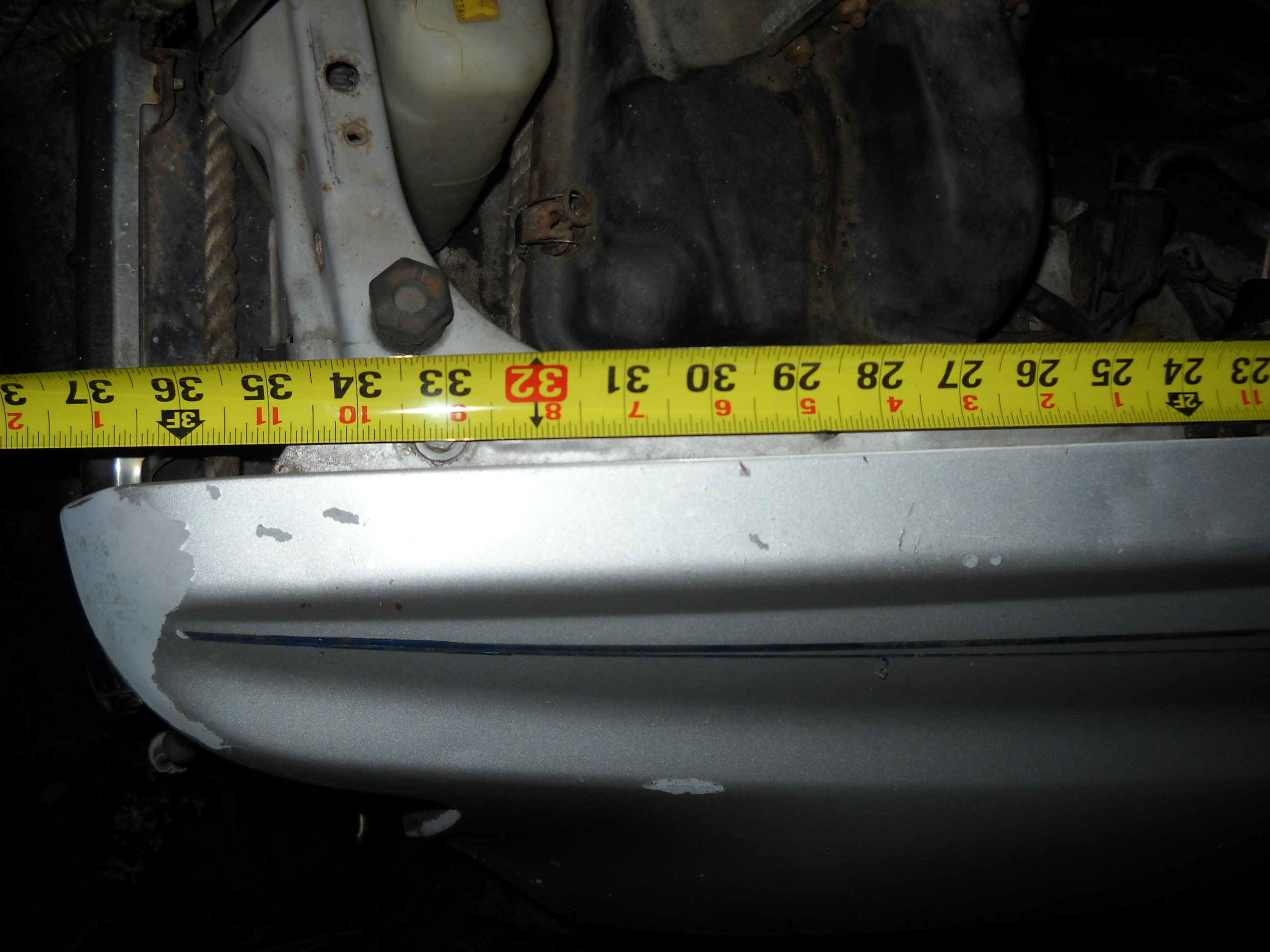

I have basically my own personal junk yard lol, went out and snapped a few photos for 86, 93, and 96 (Tacoma). All appear the further towards the windshield and front corner bolt are the same distance. Tacoma appears to curve down quicker than the older trucks though and there are less bolts in the fender. Measurement is done by hooking the tape on the furthest up bolt and measuring to the front tip bolt. Nothing else was checked, maybe some day I'll try to fit a fender on another truck for the fun of it.
Silver - 86 4x4 pickup xtra cab
Greenish Gray - 93 4x4 pickup xtra cab
Red - 96 tacoma 4x4 reg cab
