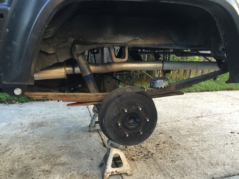

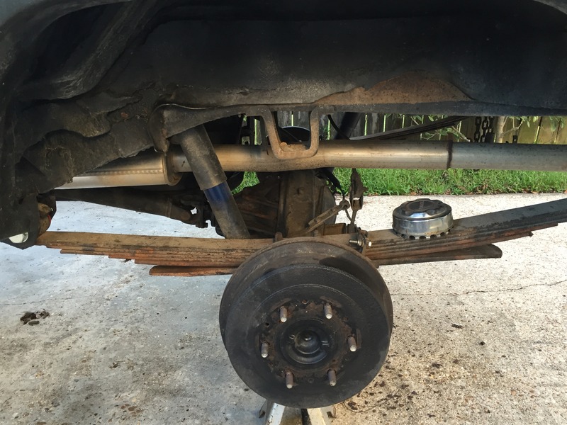

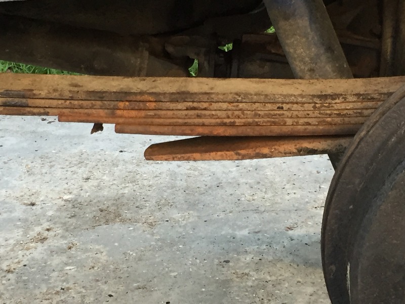

I read some posts on mud from a fella that did this on a 4runner with what appeared to be decent results. I was/am in the same boat as you. Not looking for monster height or anything, but I needed some height to clear 33s. I ended up piecing some spring together with ok results. I will have to double check what all I did, but I built the rear packs with my stock 1985 4Runner springs combined with what I believe were 1985 pickup rear springs. In the front, I believe I used one of the leafs from the rear pickup springs and one leaf from a Dodge Dakota rear spring cut down to fit correctly. I also replaced all the bushings with poly bushings at that time and used 18mm hardware. I need new shocks, but I am debating on whether to make changes or not before I invest in shocks. The only problems I have had is I think I mixed up the front springs - the driver side is lower than the passenger. And the rear driver is a little lower too - I had to use the mainspring from the pickup pack as my 4Runner leaf was physically broken at one eye. I think this is what caused a height difference between the sides.
I can get you some measurements and possibly pics this evening.
I did the same thing for my shot Tacoma rear springs using a single leaf from a Dakota pack with excellent results. I got about 3" of lift out of one leaf and have been running that way for 2-3 years now.
I didnt use any 89-95 springs, but hopefully this helps some.

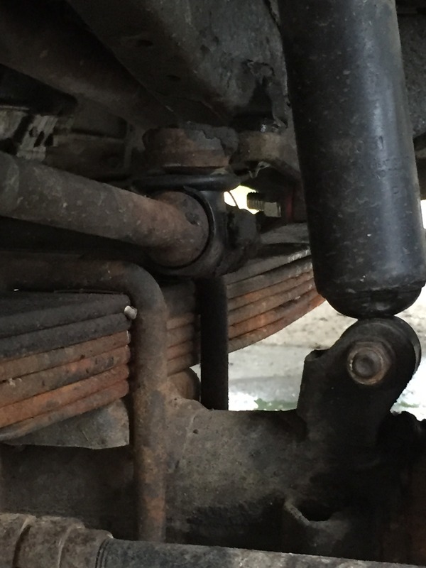

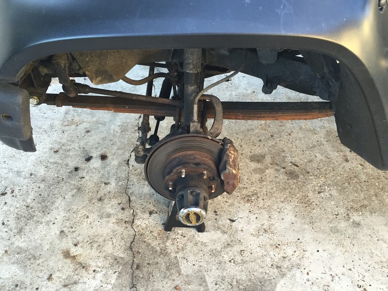

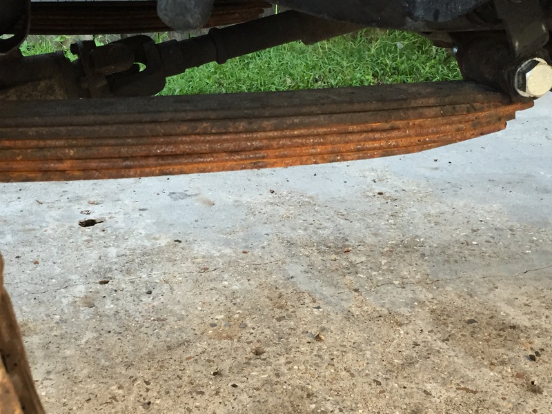

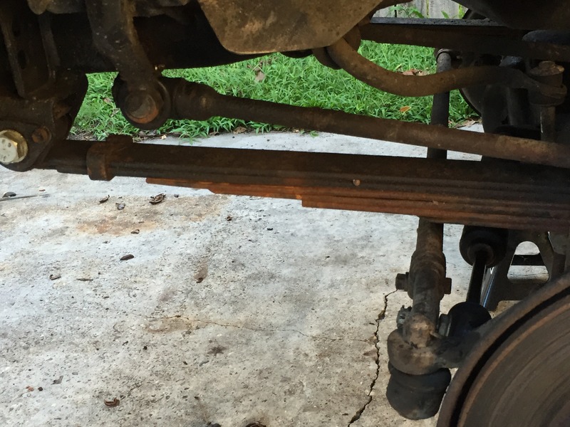

Pictures (yes the springs need painting). Wrote measurements down somewhere. Will find and send along.
Front springs

Rear

yep that's the way they should have looked from the factory! do you have any problems with your J-arm hitting the top of the springs? I read some where if you get too thick of a spring pack with the push pull steering your dragglink/J-arm will contact the top of the spring (maybe that's just with the ubolt flip). You got any pics of it on all 4?

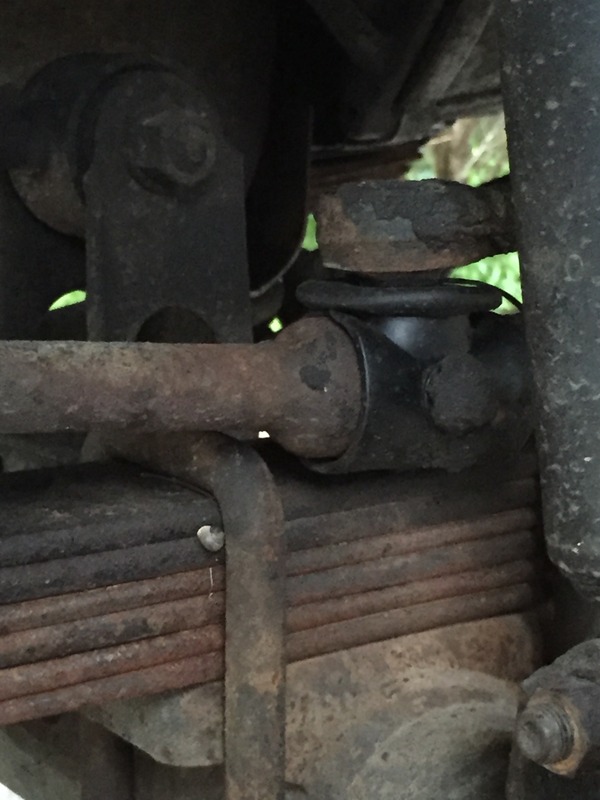

No - no problems with the J-arm, but it is a very close fit. Not sure I could put another leaf in without causing problems. No pics on all 4 right now. Awaiting new wheels. Will get some as soon as I get it all back together though.

talk about close!

I'd be very careful if the suspension is articulating (if not offroad, think driveway transition) and you are trying to turn. Thats way too close in my opinion. The last thing you want is to lose the ability to steer because it is binding up. Obviously the steering geometry is a little off, maybe there is a way to fix that? A drop draglink would fix the geometry but wouldnt give you any addition steering arm/leaf pack clearance. If you had longer stubs and could put a 1/2" or 1" spacer between the knuckle and steering arm that would help with clearance but I'm not a fan of spacers either.
