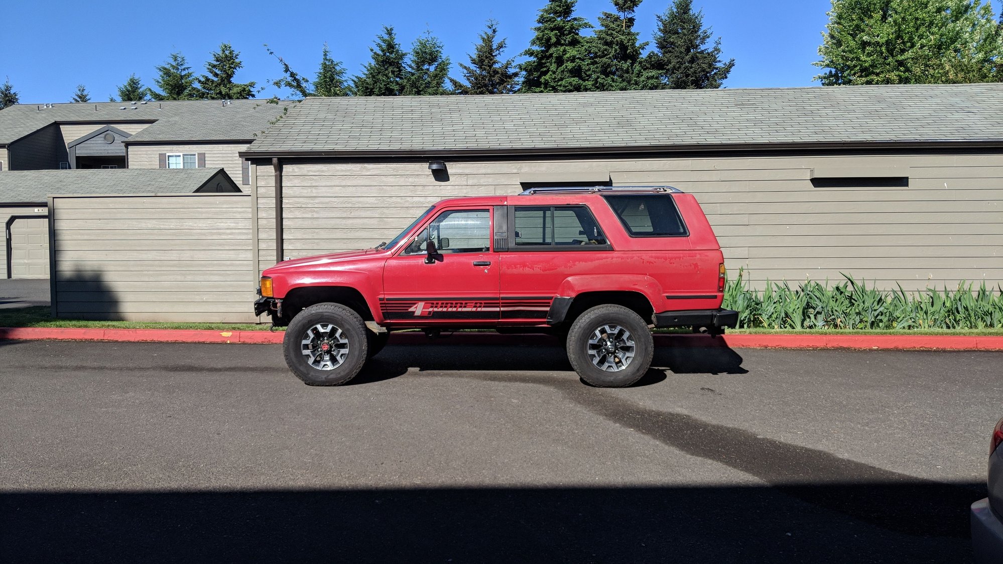

I was able to test fit the wheels and they fit perfectly. Went ahead and bought them, I'll post a picture here in a hour or so.

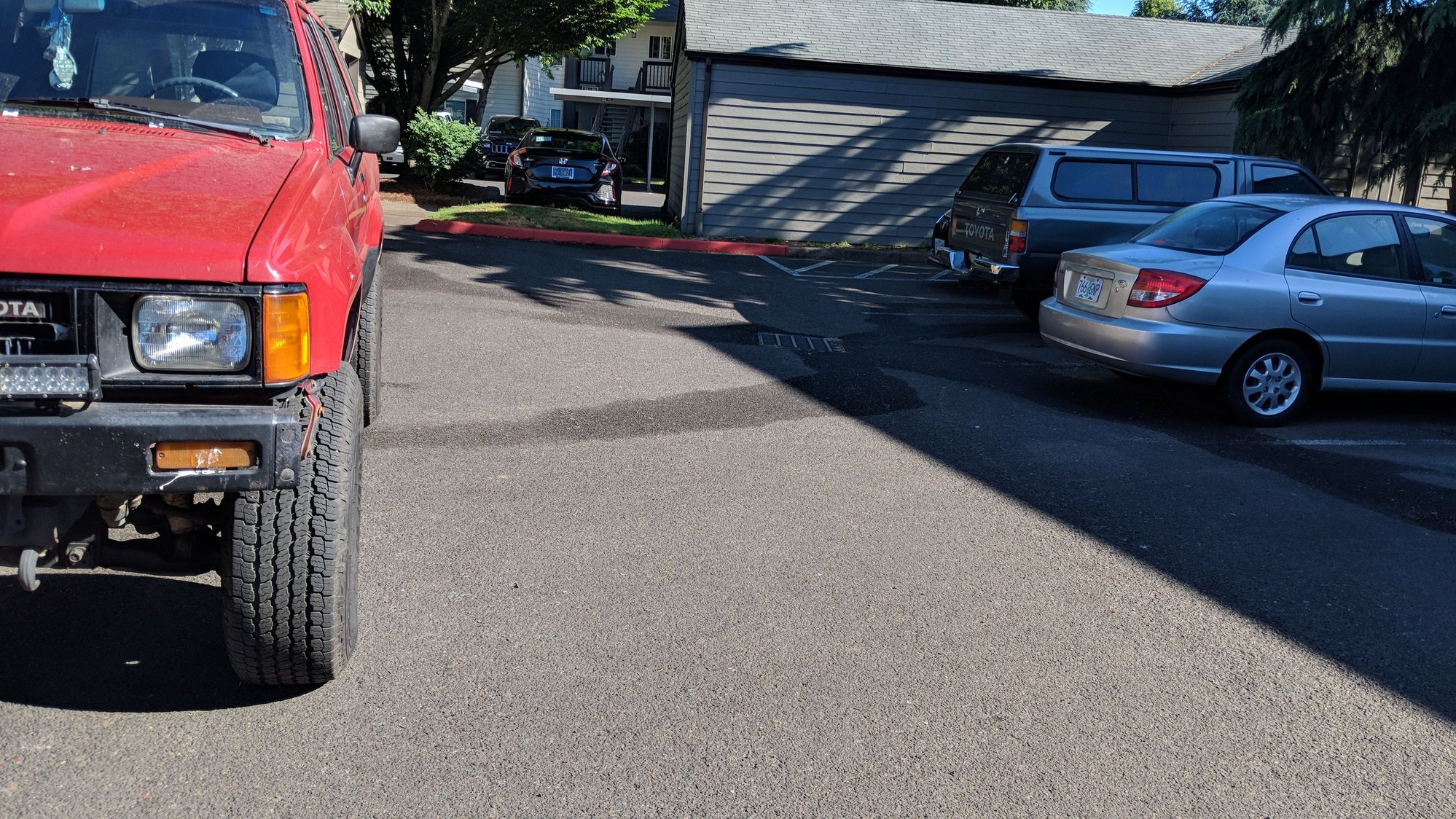

2017 TRD Tacoma 16 inch wheels on 1986 IFS 4runner, fit perfectly.

Look sharp! They don't rub at all while turning?
No rubbing so far. I checked lasntight when i test fitted them by turning lock to lock, and have driven it around a couple times now and no issues. I'll probably take it to do some fire road trails this weekend and see how it does out there. They fit pretty much exactly as my old ones did.
