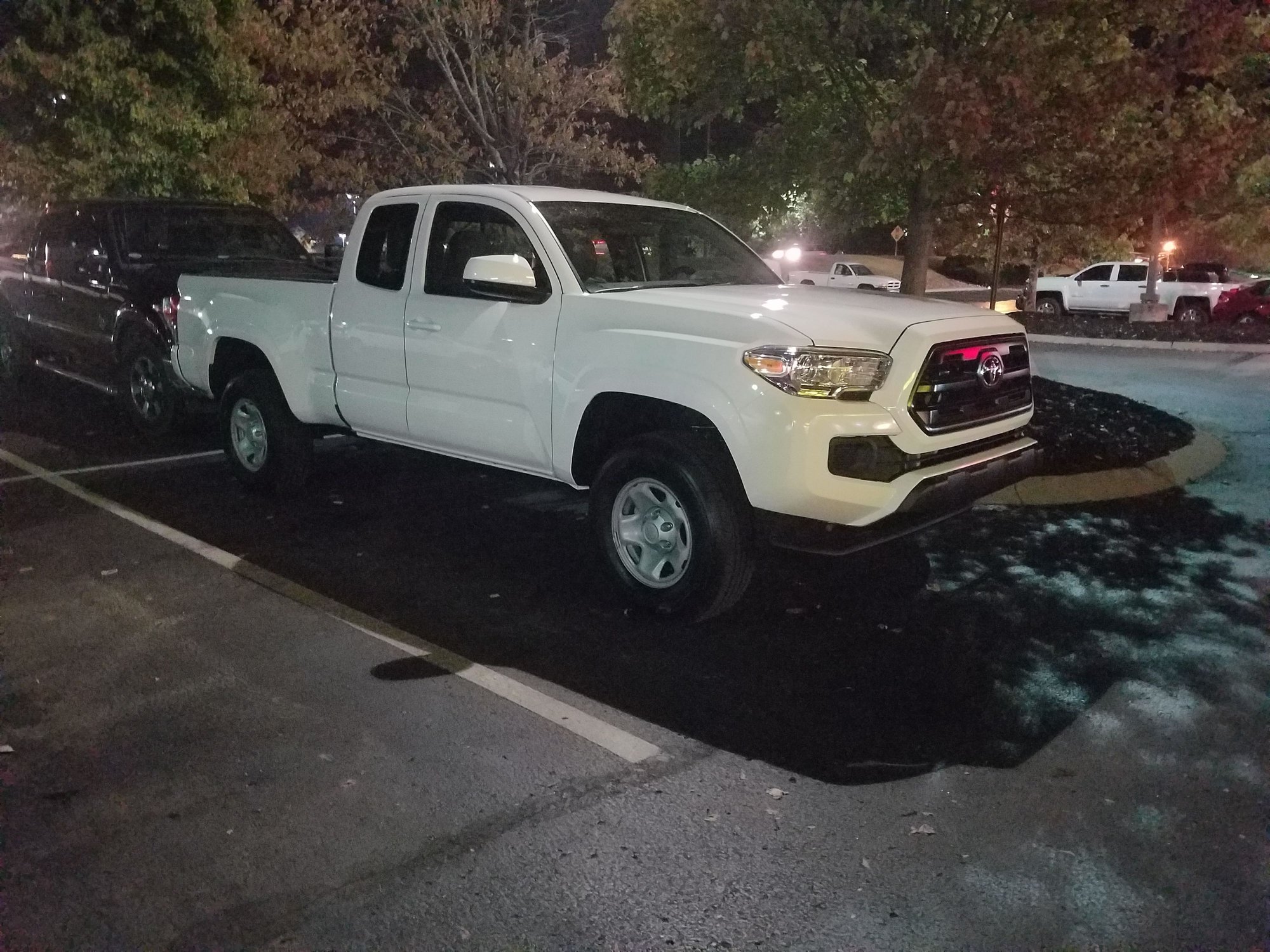

Hey folks, I just bought my first new vehicle, a 2017 Tacoma SR, 2.7l, 4x4, 5 speed.
In 4lo, I definitely think this thing performs some function of automatic LSD, although previous model trucks are said to need a modification to use this feature in 4lo.
I am an ASE certified mechanic with 20 years of off road and mechanical experience, as well as a bachelor's degree in Mechanical engineering, so I know I am not mistaking the advantages of low range for brake modulation style traction control.
On some very steep, off camber, rocky sections near my house, the new Taco climbed up easier than my lifted, locked wrangler on 33" mud tires, although the Taco is stock on street tires.
The same obstacle was almost impossible in my stock 92 4runner on 32" BFG KO2's.
Can anybody here verify whether or not the base model truck actually has this feature?
​​​​I Mean actual documentation, or perhaps someone else who has experienced this stuff under similar circumstances.
Post what you know!
