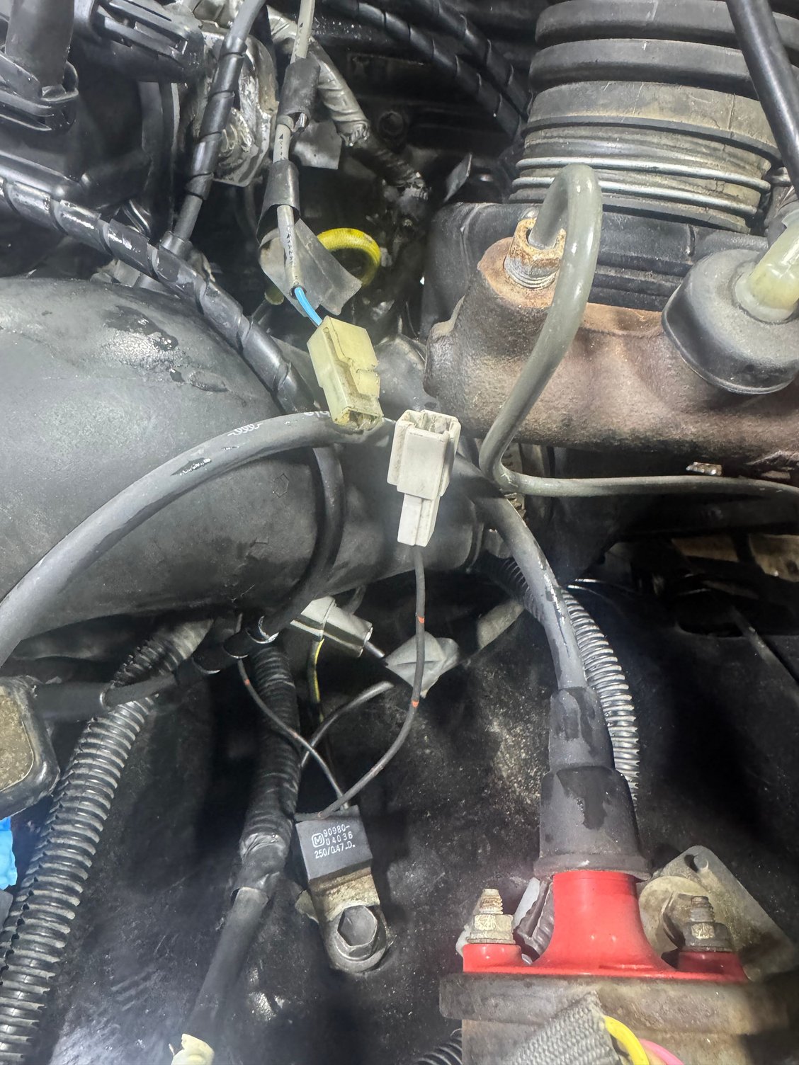

Is there a connector from the oil pressure sensor to this wire perhaps?
Here's what my wire of same color and location has for the other end that seems to connect with the capacitor....but maybe the capacitor connects elsewhere?
Thanks a ton. This is eating my lunch

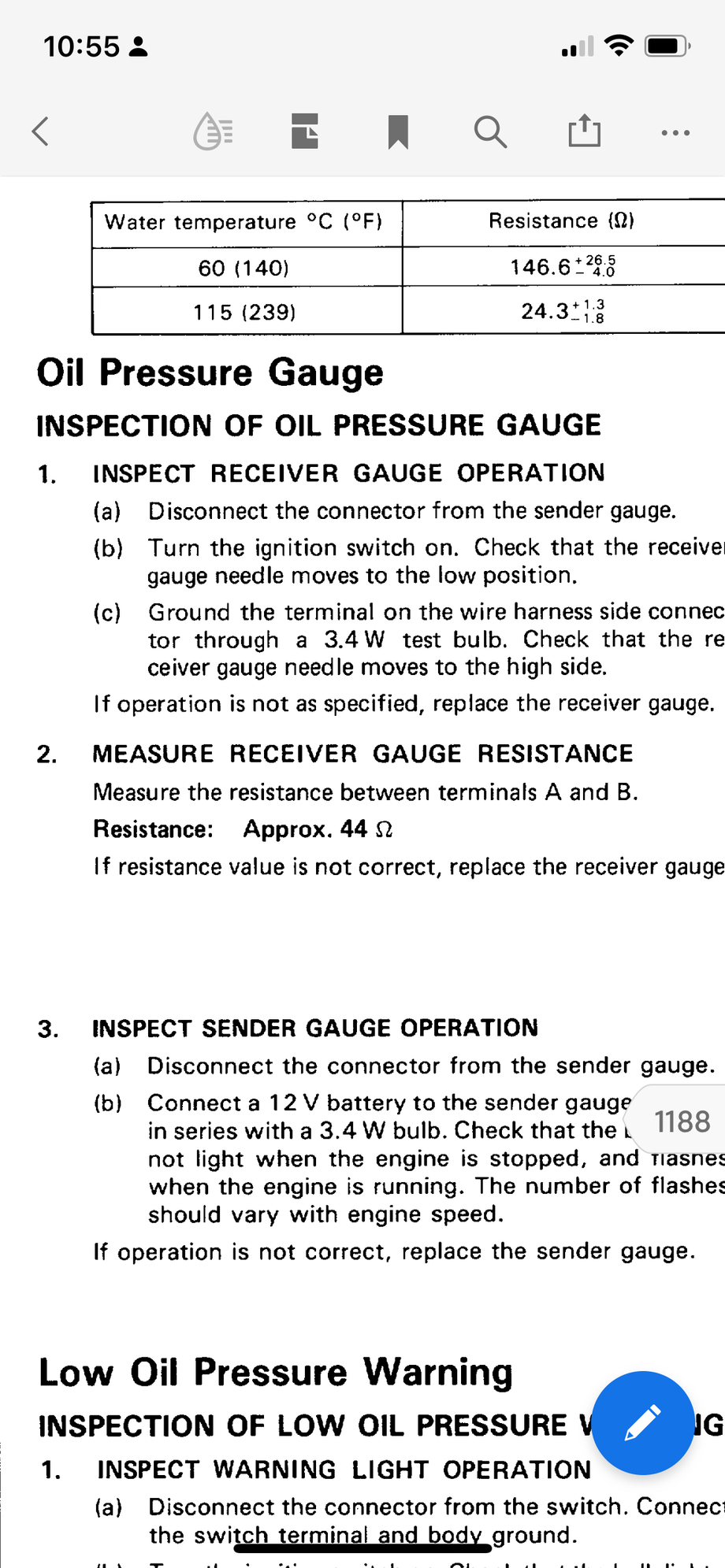

The gauge wire once upon a time should have had a little slip on spade connector with a plastic housing over it to connect to the sender. Mine was MIA. Yours might be too.
I really can’t make heads or tails of your picture or what you’re referring to as a capacitor? The noise filter on the fender? Here’s how you can test the wiring for the gauge once you locate it.
