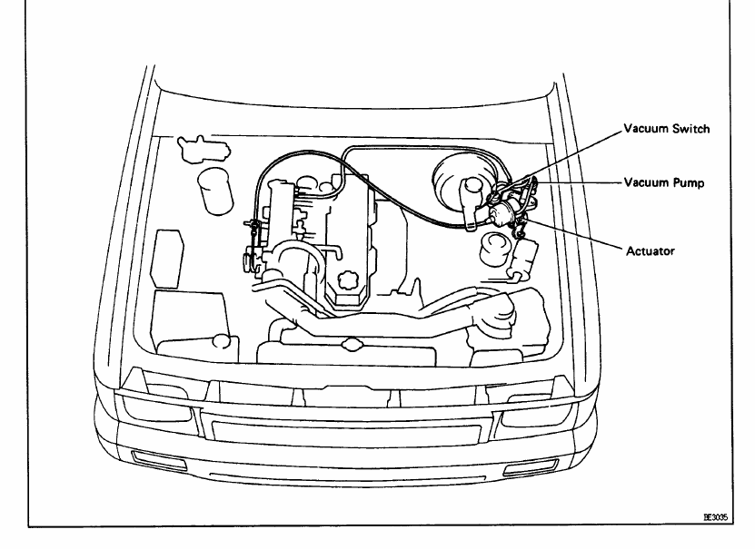

It goes to your cruise control! If you had one.

"It goes to your cruise control! If you had one."
Attached Thumbnails where does this vacuum line go???? PIC INCLUDED-cruisecontrol.png

yes it does CC i have it and thats where it goes!! if you dont hav it then cap it off buddy!
