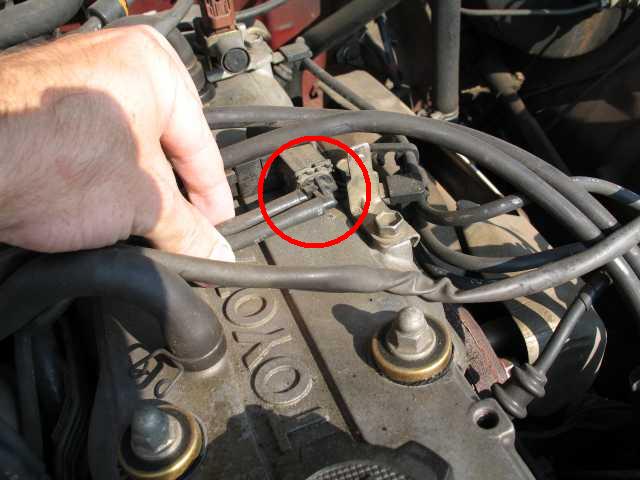

I have an 88 4runner 22re automatic and noticed this hose did not have a home. my mechanic said he was not sure and that we needed to trace it back looking at my dad's engine. my dad has a 22re but it is a 94 with different pieces in there. the hose is coming from the P on the intake. the R and the E have a place they connect to but nothing for the P. Can somebody please tell me what to do. i will try to attach a pic of what i am talking about. thanks a mil!!

here is a pic of the hose i was talking about. this is killing me!! any help would be greatly appreciated.

do you have a picture of what part it is connected too?

On mine (94 22RE), that hose connects to the air rail, i'm uploading your photos right now....

my dad's 94 22re is connected to the same spot. i have an air rail, but not another spot for the P hose. they are all taken up with the other ones.
a very helpful guy on ttora said it needs to be connected to the purge port on the charcoal canister located near the passenger side fire wall but those hoses are all connected.

I posted that before realizing that you stated it was the hose located near the P. you can disregard that post.
I guess look at the length of the hose and look at everything within the reach of that hose. looks like it can't be too far from there.

that is the thing, there is nothing at all that i can see where it could go. everything is taken up. i am very baffled by this whole thing.

Fig. 15: Emission system component layout and vacuum diagram-1988 22R-E engine From Autozone
Toyaholic, great link!
Looking at that diagram, looks like your hose got cut off, but it also looks like it goes to the charcoal canister.

the thing is, i already have the ports occupied on the charcoal canister. the one coming out of the purge port is hooked up to a spot on the intake manifold. see pic of what i am talking about.

does the truck run? if so does it run well? the hoses may be in the wrong place. you could try running them all just like in the diagram. get some extra hose if you need it and look at some of the other diagrams. the one posted may not be your exact one. take another picture with a higher resolution so we can zoom in and take it from above so that we can see everything and don't worry about putting your hand in the picture so you don't hide anythiing.

It looks like the charcoal canister is going to the wrong port. Attach the charcoal canister to the P port and see if it runs any better. It would probably be a good idea to plug that other port until you figure out what goes to it.

i am afraid of doing that for fear of messing something up. I have printed all of the diagrams that have been posted so far and will bring thme to my mechanic to see what he says. i guess i could color code these hoses so i know where they go if i have to put it back. here is a link to more pics of my engine. i took pics from different angles.
