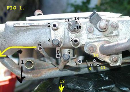

Where do the other end of these power steering hoses go?
I was re-assembling my engine back in the engine compartment and at the end of the night I saw two hoses that go onto what appears to be a sensor of some sort. Instead of spending an hour looking for where it goes, i thought id end my night in peace and just ask if someone can easily tell me where these go?? thanks!!!

It's the idle up.... needs some vacuum lines.
Will up the idle when turning while stopped (or engine is idling).

i have the same problem, i know they are vacuum lines but i also disconnected a fuel line the same size and cant figure out what lines they connect to on the plenum.

Where it says "Power steer."

7 and 8
Hope this helps
