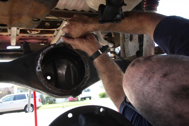

You will have to pull the 3rd just use rtv to seal it. There are several write ups on how to do it.

RTV that bugger....Name:  IMG_1697_zps883820a8.jpg
