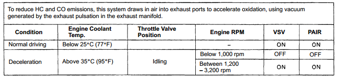

The hesitation problem existed before the head gasket. My based timing checks outs. The pair valve is operating correctly but the ecm is sending the signal to activated the vsv most all the time. When the vsv disengages its not consistent. The good book say the vsv should :
so is it safe to say the ecm does not see the rpm or the coolant temp? A lack of either of these two could diffidently cause my problem, correct?
